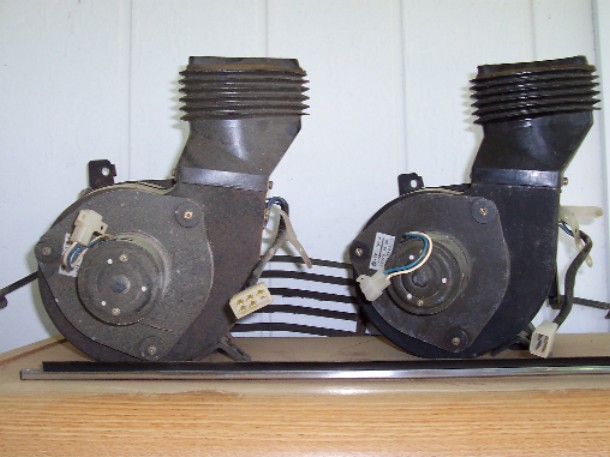

Well, it's not quite an emergency, but I could use some advice. About four months ago, I was pulling out of a parking garage & smelled smoke. I got the fire out, drove it home & was so disgusted I parked the Z for 4 months while I worked on other projects.
Today I finally crawled under the dash & found what happened. I think the heater switch failed & started a fire. I'm not sure why, but a couple of suspicions:

I did some checking & you can't just replace the unit. You can see the fan blade is melted & will wobble from now on. Any source on parts for it? I'd like to replace the melted duct, but a junk yard is the only likely source. I've not had much luck here (New Orleans area). What about the heater switch - I guess I can just replace the switch. Anything I need to know that could cause problems there?
Dave-
I've got a blower unit complete w/o the flex. duct (just sold that recently), however, this one is for units w/o A/C. The dropping resistors (the wire wounds inside the heater blower case you see in your pic) are wired to your switch, however, I tend to believe that some crud was in there that when it got hot (from the heat dissipation of the resistor switch), it started a fire. Do you recall what fan setting you had it on? "HI" is basically a straight short, where the other speeds use the resistance. Send me a PM if you are interested. The unit that I don't need is on the right. I also have the fan switch for 3 speeds if you are interested in that.

Thanks, but I'm going to look around a bit & see if I can find one for the air, but I'll keep it in mind. I will have to replace the blower motor - it had been making some noise :stupid: , when I pulled it apart - the armature is very worn. Probably was arcing. Not sure the picture really does it justice.
