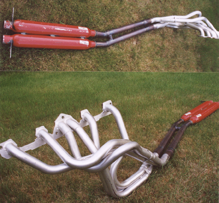

This is how I did it. The header is made by Stahl. It was made with 1.5 in. primarys, and a two inch collector/ tail pipe size. This was sized for a 240, but I'm going to run it on a 3.0 L-motor for vintage, track fun, and street mayhem. As Gary mentioned, a crossover/conector pipe can be seen installed in front of the muffs. The muffs exit at the diff. I have 3 inch ID short race muffs acting as resonators which exit at the stock location. The two pipes are only connected at the crossover point. Great sound. All bends were cut fron mandrel tubes and heli-arc welded. The muffs lay up close under the drive shaft, and the car can sit low with no road rash.
Phred
Phred, that's a hell of a systime . Looks like you did a lot of work to keep the plumbing equal in length . How is the sound with the glass packs , I know you said great sound , but for a race car or for a street driver . I dont want to be setting off a bunch of car alarms ! Great looking set up , I hope to see it soon. Gary

The exhaust I made from 2 RC40 systems that are sold by Mini Spares in the UK. I´ve calculated that there should be no powerloss up to 260 hp ! The car certainly pulls a lot harder & sounds great but not too loud. & took a whole weekend to make !

Phred,
As usual Stahl makes a super looking header! I didn't know they made one for the L6 Z.
Is there any benefit to mounting the glass packs in the center of the system rather than at the end like the twice pipes?
I had thought of installing a resonator in the center and leaving my glass packs at the rear. Any thoughts? The crossover you installed is what I'm planning, only a little closer to the header.
