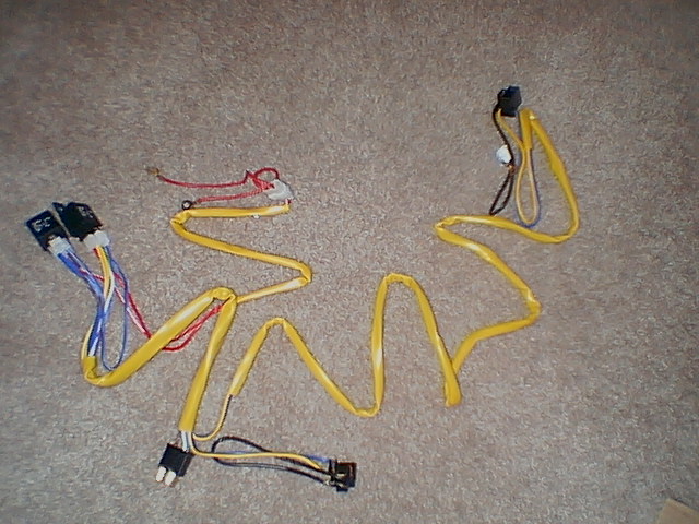

August 9, 200519 yr comment_133546 alright well I just ordered Victoria British's Heavy Duty Headlight harness for $29.99 so I wil let you guys know how it turns out when I recieve it! Link to comment https://www.classiczcars.com/forums/topic/13033-headlight-wiring/?&page=3#findComment-133546 Share on other sites More sharing options...

August 11, 200519 yr comment_133752 shipping for me was $10 what a rip.. but anyway.. well see how nice it is when it arrives.. if only someone made kits for a 280Z!! ugghmm Link to comment https://www.classiczcars.com/forums/topic/13033-headlight-wiring/?&page=3#findComment-133752 Share on other sites More sharing options...

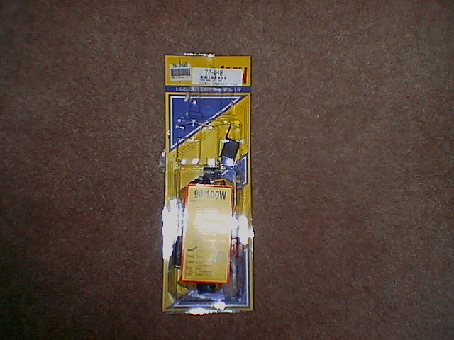

August 13, 200519 yr comment_134049 here are 2 pics of the VB harness... Link to comment https://www.classiczcars.com/forums/topic/13033-headlight-wiring/?&page=3#findComment-134049 Share on other sites More sharing options...
August 17, 200519 yr comment_134420 Gary, all,That price is from last November. I PM'd Dave last week and he is gathering parts for a new batch, still 240Z only. The price is now $83 to your door. Prox, please let us know how that VB harness works for ya. Link to comment https://www.classiczcars.com/forums/topic/13033-headlight-wiring/?&page=3#findComment-134420 Share on other sites More sharing options...
