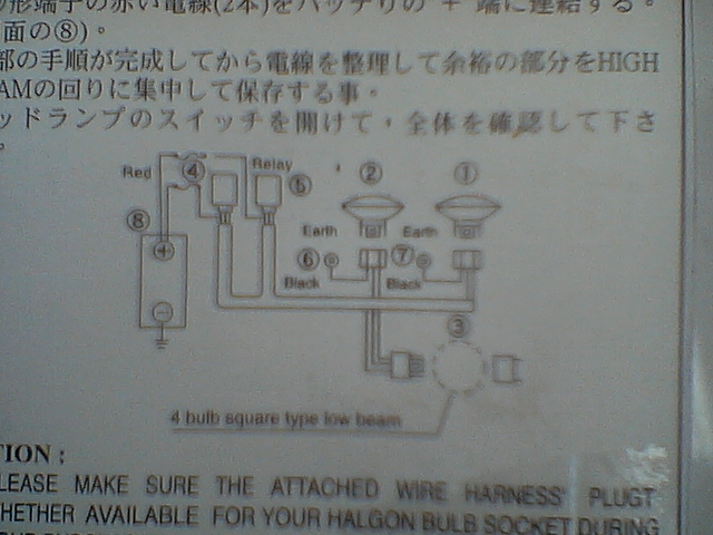

I'll take a pic of the diagram tonight

from the sound of that and and Prox's description, I would think that all you need to do is disconnect the old light connectors, plug in the new ones, hook up the battery wire & ground, mount the relays and connect the two wires for the switching from one of the old light sockets.
They just made the cross-over section too short.

Prox, I would like to see some pics as how you did yours. I read your posts and I might have to be out looking at my car to see where you are talking about with the switch harness.

i'll take some pics tomarrow.. my day off... for the wiring

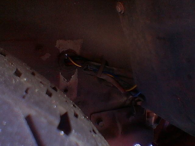

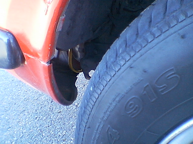

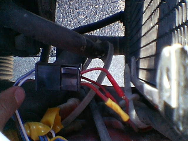

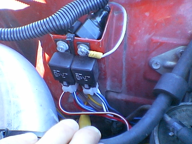

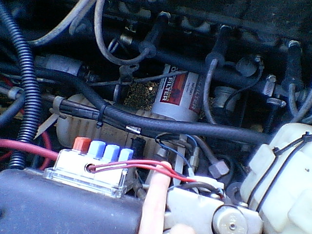

Here's some pics of the harness and relays
the 2nd picture is the pic of the original circular plug CUT OFF and i used crimps to attach the new plug. the plug i sourced from the OLD headlight plug which plugged into the back of the original headlight which was no longer needed.
