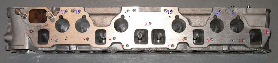

To notch the E88 head for the injectors use a colored grease or spotting
die. Smear it on the intake manifold face and slide it on the mounting studs
to "spot" the intake face shape on the head. Scribe the injector area with something sharp as not to lose that shape and be able to wipe the grease/spotting die off before working. See the fuel injected head for the
notch angle. Good luck - you should do fine.

Keep in mind there are two versions of the E88. The later ones from 73 have a larger combusition chamber and hence a lower CR. They're not bad, but not necessarily desirable either.
So I have to ask why you want to switch your N42 head to an E88? While there's nothing wrong with an E88, the N42 has larger valves and about the same combusition chamber size as the better of the E88s. If you're planning to rebuld a head and add a cam, I'd suggest you keep your N42 and use the money you were going to spend replacing it towards that project.
BTW, I just put an N42 head on my L28 dished pistons with a mild cam. Much improved high end power and almost no loss of low RPM torque. I replaced a stock E31, FWIW.
