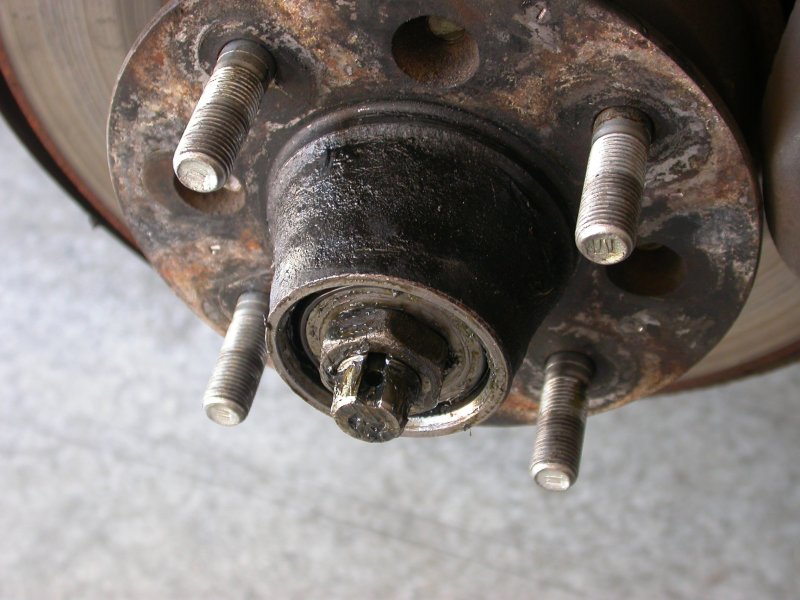

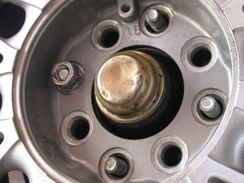

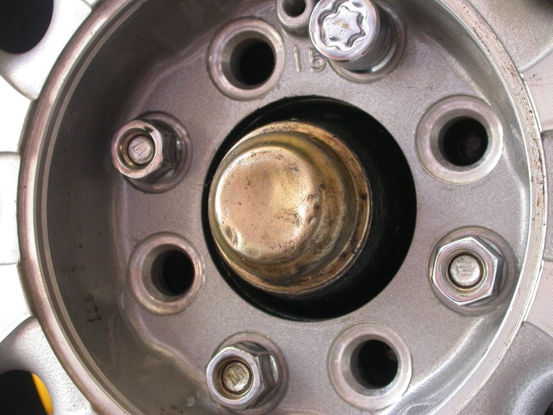

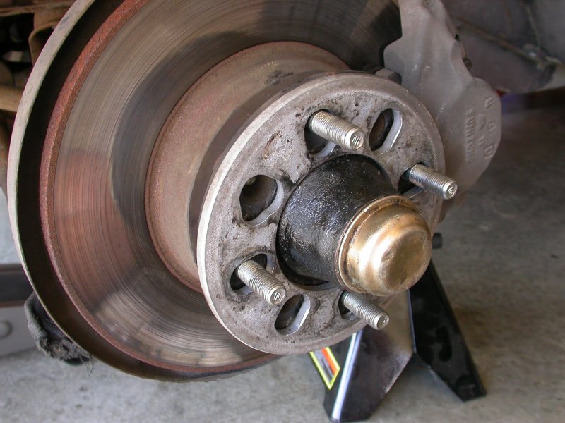

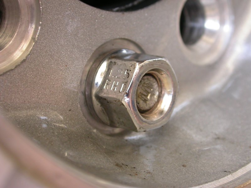

Advice needed. When I got my 280Z, it had ARE wheels on it, and those required about a 3/8" spacer with them to clear the spring on the inside. Whoever installed the wheels and spacers also installed longer wheel studs to get the job done. However, those studs look like they might be a little short. See the pics attached, where the nut doesn't quite catch all its threads on the studs when tightened down. So, does it look to anyone like this is an unsafe configuration?
I am currently rebuilding a spare 280Z front suspension (tie rods, ball joints, bushings, shocks, springs, wheel bearings, paint, etc.), so now would be a very good time to get longer studs. If that would be a good idea, where would you suggest I get them? In about 1987, I was rolling down CA highway 5 out in the middle of nowhere in my 1975 280Z, and 3 out of four wheelstuds snapped on the right front and left me stranded (I think, but couldn't prove that a tire place had air-wrenched them and cracked them), so I'm a bit paranoid about wheel studs.

I'd want the end of the stud to at least be flush with the outside edge of the nut, to make sure all threads on the nut are engaged on the stud.
