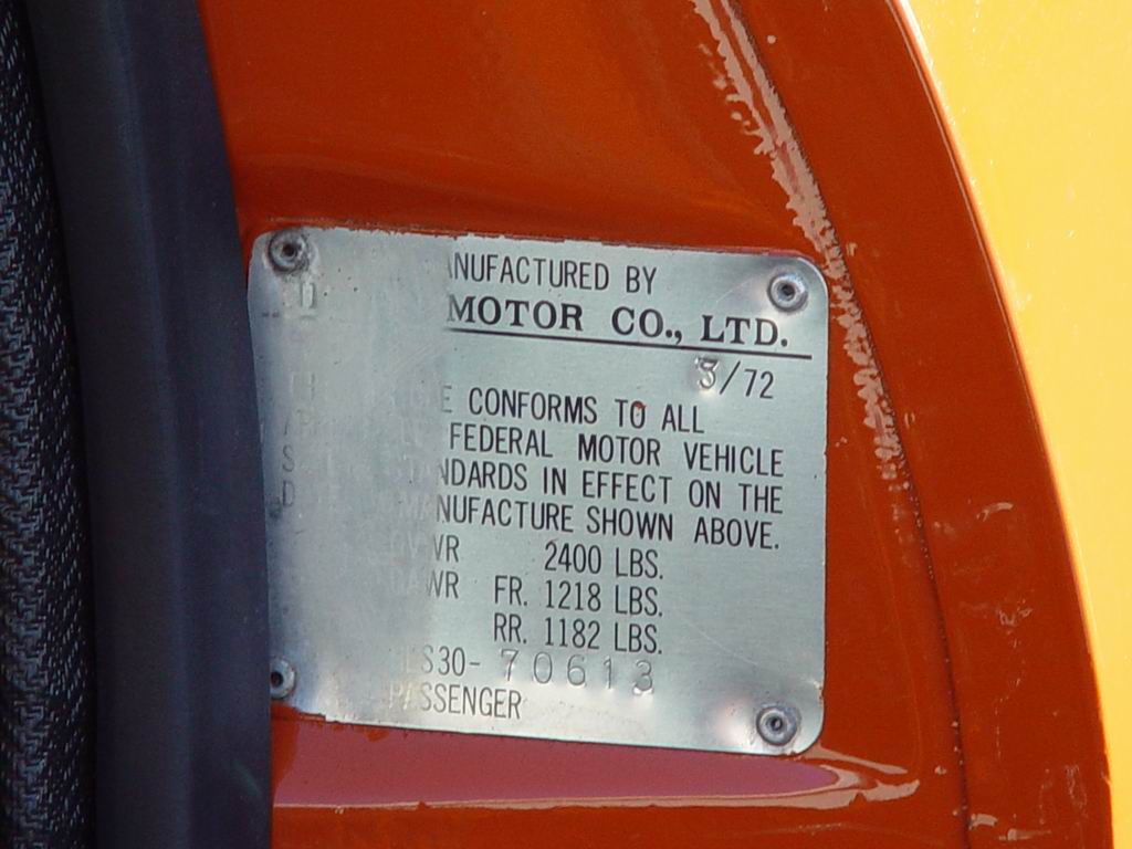

Oh yeah, and you are right Walter, the sticker in the glove box lists 400lbs as the maximum permissible load. I'll try and remember and take a picture tomorrow since i've never come across a picture of this sticker on the site.

I had forgotten to followup on this last year, I did take a picture of the glovebox sticker in my 03/72 stamped car, I just forgot to upload it. Here it is.
If you add the "permissible vehicle load capacity" of 420lbs to the GVWR of 2400, it is obviously 2820. I think Carl is right on here and Nissan just goofed up or for some reason was transitioning how they did the numbers.
The picture came out pretty poor, but you can make out the important info.
