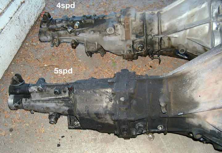

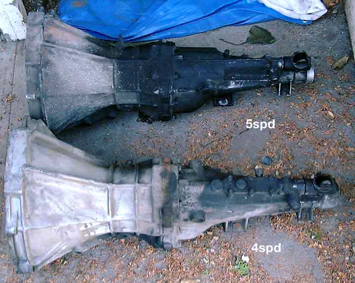

In the pics I've attached the one labelled 4spd is a B box on loan from fellow club member Victor Laury (thanks Victor), the tranny labelled 5spd is a gift from another club member (thanks sennavsprost) before he moved up to San Francisco.

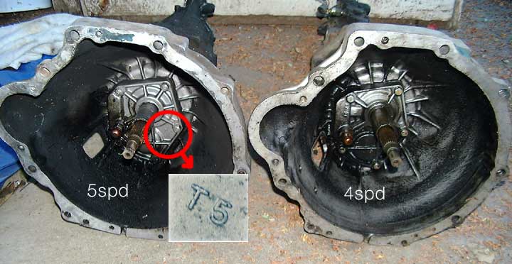

The thing about the 5spd I was given is that he thought it to be a T5 based on the "T5" stamp inside the bellhousing which I've enlarged for you all to see.
What's weird though is that I had another club member send me photocopies of the tranny tear-down pages for an '81-'82 T5 FS5R90A and the illustrations don't match at all what I'm looking at it. I compared what I have here with the illustrations of the optional 5spd FS5C71A in both my '73 Nissan SM and '70-78 Haynes SM and it doesn't match either.
So what 5spd is this?
I need to order parts for it and obviously need to know what car to get them from...

The Borg Warner T-5 would have a removable bell housing and a different shift lever mechanism.
To add to Stephens description............I don't know anyone who would say a T5 "felt a lot tighter and more precise" than a Nissan transmission.
