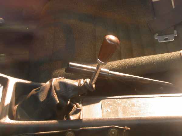

I don't have a 'nude' lever pic to hand, but I have a pic of one as installed in a Works rally car.
Maybe it will give you an idea of just how extreme these bends are. They are probably not far off 90 degrees ( twice ).
