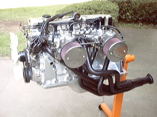

I ended up not using these and just using a stock exhaust manifold. The header had some other problems aside from the flange being too thin (this was an MSA 6-2-1 header). The collector pipe would not fit any way I manipulated it. I would have had to have a shop bend the 2 pipes so it would fit properly, and doing so would likely warp the flange since that was the only thing between the front 3 and rear 3 pipes.
That and I wasn't exactly confident about the condition of some of the studs. The shop I bought the raw head from did a pretty damn poor job (some place called TGSI or something in california that races opel GTs primarily). These guys apparently have no clue how to install a helicoil and this ended up causing me an enormous amount of grief. So torquing down a header to prevent leaks wasn't really something I was comfortable with. Maybe in the future when I have a different motor.
I too had no problem with the MSA 6into1 unit and did not need stepped washers. You do need the thick stock manifold washers for the bottom studs that are shared by the intake manifold. BUT! There is no telling if your manifold will be the same. Take your time and check twice if the exhaust flange and intake flange are the same height. If you do'nt bother, and slap it together, you can have a really ugly time getting things to seal. The Nissan fat manifold washers have enough material to grind away to make up for small diffrences.
I think i've caused some confusion in this thread about the different header types MSA sells
when I said 6-2-1 I meant it goes from 6 primaries into 2 collectors and then down to 1 collector. So the one I had my trouble with was the other one msa sells.
The only reason I havent flipped out and sent it back is because I plan to forget the collector someday and run a seperate pipe for the front 3 and back 3 432 style perhaps. It sits under my bench in the garage for now :(
the collector was about 1/2 inch to high in the transmission tunnel
