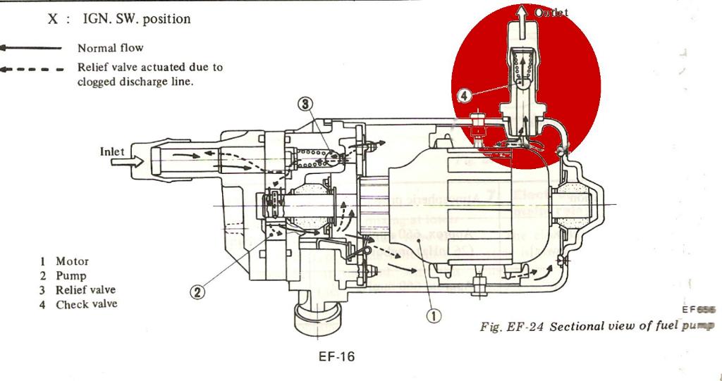

My 78 Datsun 280Z has been giving me some problems in that it seems it has a bit of a problem in handling its fuel. I have checked the fuel pump pressure and ran fuel injector cleaner through it a number of times with little to no results.
When preparing to start the car I normally need to leave the key in the on position for several minutes before the car will even attempt to start. Once started it will run fine for a few minutes and then it will start to cut-out. When you try to accellerate sometimes it's fine, other times it attempts to die.
The oddest thing of all is that when I have the key in the on position without the car running I can hear a gurggling in the gas tank - I have no idea what that could be, but I'd bet it has something to do with my problem.
Znut, your problem sounds like it could be a bad check vavle on the fuel pump. A bad one will not allow the system to hold fuel pressure. I don't know if you can just get a check valve but they do come with the fuel pump.
