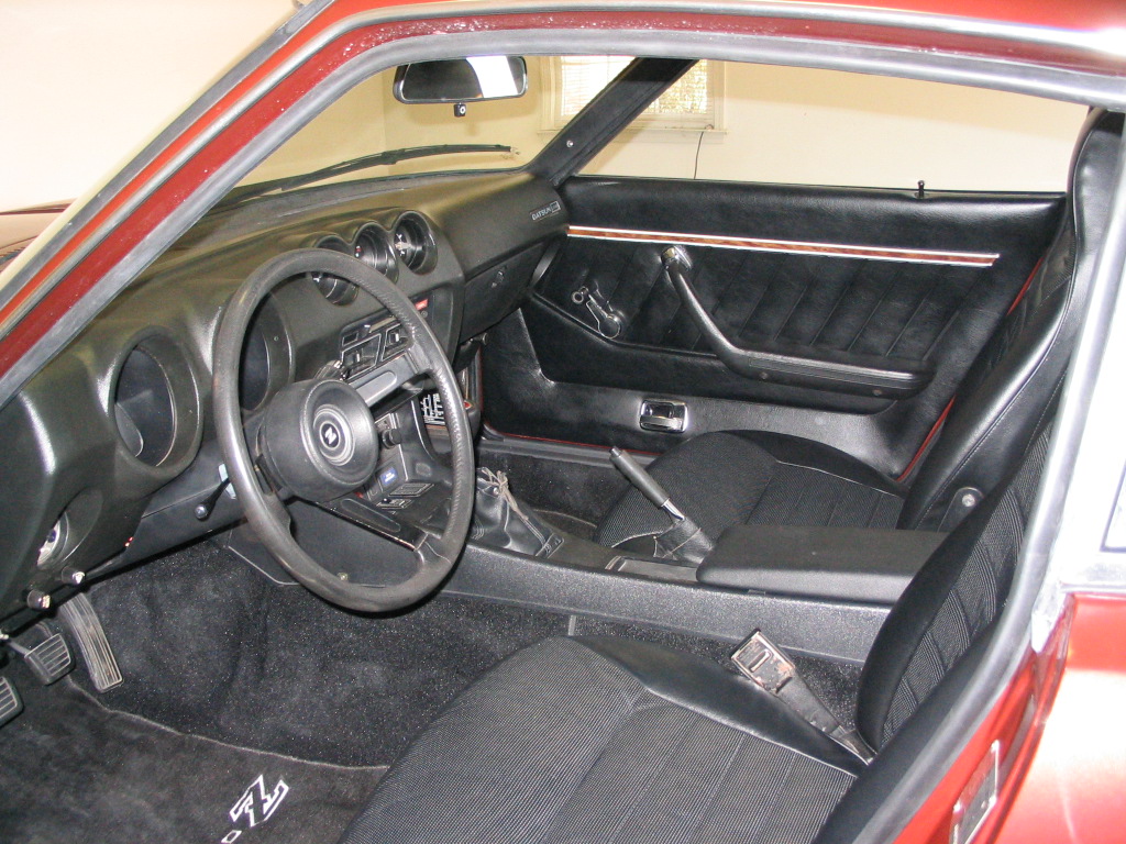

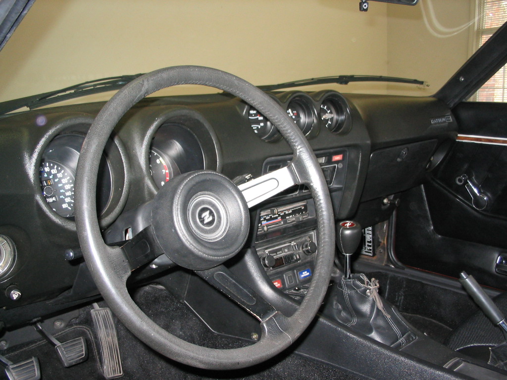

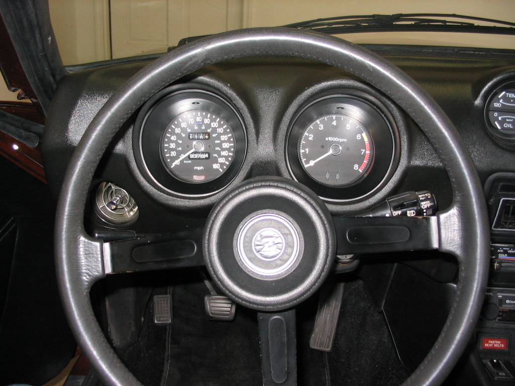

January 1, 200520 yr comment_106849 VB T/S switch installed yesterday. Works great. It is not a Nissan part but an aftermarket piece. Swapped out the old capped dash & covered steering wheel at the same time. Link to comment https://www.classiczcars.com/forums/topic/13499-turn-siganls-ahhh/?&page=2#findComment-106849 Share on other sites More sharing options...
