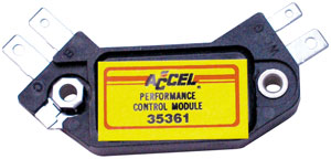

Posted October 22, 200420 yr comment_99009 After checking almost anything to track down my itermittent miss I can think of I am certain that my e12-80 ignition module is cactus :mad: . Nissan wants a stupid amount of money for a new one ($300ish), I can get an aftermarket one from Petroject for $150, or $175 from a zed shop south of the border.What my question is, the GM swap that is popular in the states, has anybody tried that here? I've seen the write-up on zhome, anybody know if the module is on an aussie holden somewhere?And whatever I do get, does anybody insulate them? To try and prolong their life?Thanks for the help.Luke Link to comment https://www.classiczcars.com/forums/topic/13720-aftermarket-ign-module/ Share on other sites More sharing options...

October 23, 200420 yr comment_99209 What my question is, the GM swap that is popular in the states, has anybody tried that here? I've seen the write-up on zhome, anybody know if the module is on an aussie holden somewhere?Luke Luke, if you have any GM/Holdens with the HEI distributor, the module from that is what you'd need for that conversion. I'm running one made by Accel on my 72 right now. Chris Link to comment https://www.classiczcars.com/forums/topic/13720-aftermarket-ign-module/#findComment-99209 Share on other sites More sharing options...
October 23, 200420 yr comment_99243 I am running the gm module conversion it works great. I used a piece of aluminum from a local machine shop, but before i got that piece I used a galvanized piece of steel. Just use that dielithium grease on the back of the module. This is your ground, then make sure that the surface that you mount your contraption to is a good clean chassis ground...dielithium grease helps here too (the module will fry instantly without a good ground). If you can't find the module try advanceautoparts.com, I think they ship worldwide and the part ws les s than twenty bucks. Hope this helps.Dan Link to comment https://www.classiczcars.com/forums/topic/13720-aftermarket-ign-module/#findComment-99243 Share on other sites More sharing options...

October 26, 200420 yr Author comment_99626 Well I ended up getting an aftermarket replacement for the original E12-80 module. Exactly the same casing, direct replacement. Can't complain about that! Anyone chasing the same, I got it through Coventry for $99. #IM1192 Year warranty. Bargain considering the same part was $157 at other places.Hehe think I'll take the zed out this afternoon :devious: Luke Link to comment https://www.classiczcars.com/forums/topic/13720-aftermarket-ign-module/#findComment-99626 Share on other sites More sharing options...
