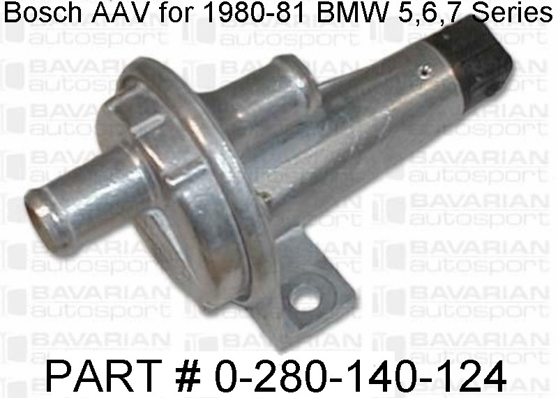

Well the Nissan F.I. system is based on the Bosch L-Jetronic fuel injection used on BMW, Mercedes etc. But it is their own version of the system. Through the years, parts have been interchanged such as the air regulator, the thermotime switch, the temperature sensor, etc. with the German counterparts. The Nissan parts were made by JECS. The Bosch parts are interchangable and, in my opinion, better. If you have a VDO (German) thermotime switch, it has been changed from the original JECS (Japaneese) thermotime switch. The German parts were common replacements on the 280Z, 280ZX, 810, 910 (Maxima) and any of the other 4 or 6 cylinder cars with L or Z (N.A.P.S.) engines. My own personal research which spans about 15 years now does show that the German parts actually last longer. The thermotime switch and temperature sensor from any of the late 70s to mid 80s BMW 6 cylinder engines work on any of the L series f.i. engines but only the air regulator with the number '0 280 140 124' will work on the Z engine. I believe that one comes from the 80 to 83 BMW 6 cyl.
Is that the AFM? I would probably like to have one on hand, just in case.
No, that's just the air regulator or auxiliary air valve. It adds extra air to the mix to help the engine warm up.

I was looking at this old post and I noticed that my description of what the auxiliary air regulator does was wrong. I doesn't add extra air to the mix, it bypasses the throttle plate which raises the idle speed. Maybe that's basically the same thing, however.
