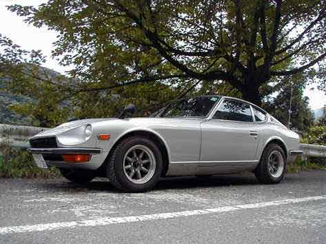

The silver Z:
front: type A +3mm 14 by 7j
Rear: type A -3.5mm 14 by 7.5j

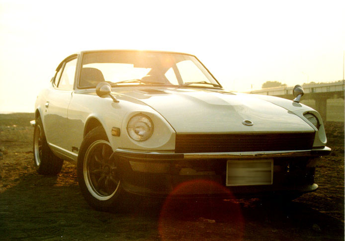

The white Z has the recommended Watanabe sizes for the 15" wheels as stated above.
p.s. These pictures were taken from the Rs-Watanabe website.
