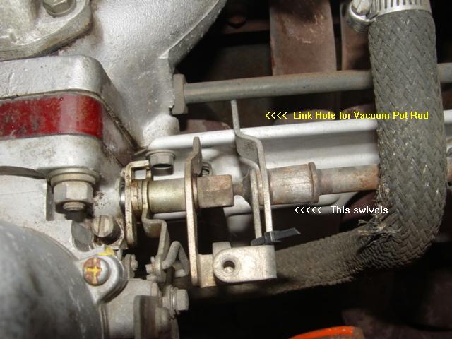

November 20, 200420 yr Author comment_102587 Pressedsteel, I think your most likely correct. I can almost guarntee that if i was to go buy some more plugs it would run great for a little bit, untill they fouled out again. Im going to order the carb video ASAP. Im suspecting the carbs even more now after this discovery. Check out the zip tie in the picture and the missing adjuster screw. That can't be good. :surprised Link to comment https://www.classiczcars.com/forums/topic/14052-first-drive-in-the-z-backfiring-and-sputtering/?&page=2#findComment-102587 Share on other sites More sharing options...

November 20, 200420 yr comment_102591 FWIW, the missing screw doesn't have anything to do with setting the fuel mixture, it's related to balancing the operation of one carb against the operation of the other carb. Link to comment https://www.classiczcars.com/forums/topic/14052-first-drive-in-the-z-backfiring-and-sputtering/?&page=2#findComment-102591 Share on other sites More sharing options...
November 20, 200420 yr comment_102594 FWIW, the missing screw doesn't have anything to do with setting the fuel mixture, it's related to balancing the operation of one carb against the operation of the other carb. That's correct, except that it is the balance screw for part of the system that your car apparently has had removed. The Air Pump for the "smog" system has been removed from your car, and the vacuum pot that prevents the carbs from "slamming shut" has been removed. This is where it hooks up to. The screw you are missing is to balance the carbs upon deceleration. If you were to cut that zip-tie you'd note that the linkage will just flip flop around and do nothing. As far as determining that the vacuum advance system in the dizzy is still ok, look well underneath the points plate. If you see a ball bearing or two floating around in there, then it is shot. I'm not sure that 1/8" of travel is sufficient to consider it functioning well. I'm of the opinion that you should try the LEAST intrusive remedies first. That means that you should check all the items that do not require massive disassembly, adjustment or changes, BEFORE you go doing those changes. Remember, the car did RUN, as such, I don't think you need to disassemble the whole thing only to discover it's a bad plug wire, plug, filter, or adjustment. The things that everyone has been mentioning are the type of items that they've had experience with, and as such are the first things that come to mind, exactly as Zedrally points out. The gas problem is something you should have done something about. However, by now it would be hard to drain and clean without having a very hazardous situation on your hands. If you do decide to drain the tank, be very careful as 15 gallons of gas is not something you just want sloshing around on your driveway. If you do drain the tank, then decidedly change the fuel filters even if you "just" changed them. 2¢ Enrique Link to comment https://www.classiczcars.com/forums/topic/14052-first-drive-in-the-z-backfiring-and-sputtering/?&page=2#findComment-102594 Share on other sites More sharing options...
