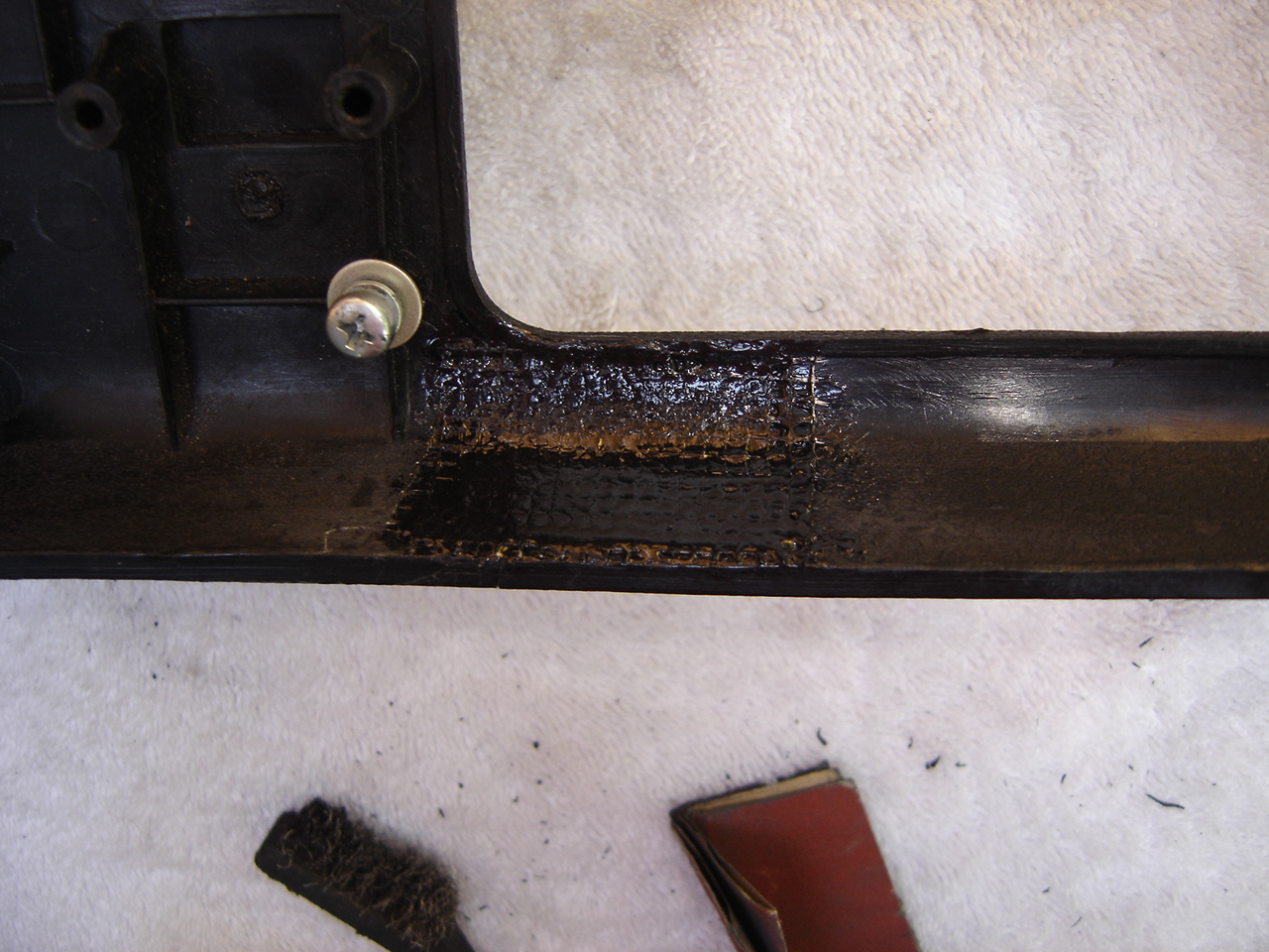

Some fiberglass drywall joint tape and ABS cement works great so far!  Only time will tell.
How long did it take for the ABS cement to dry when you used it with the fiberglass joint tape?  Single thin coat or several coats?
Dennis
It dries really fast!  I've only put on one layer and coat so far and after 15 minutes I was handling it pretty normal, almost trying to break it loose. :D
I cut the fiberglass to size.  Put a thin layer of ABS down, too thin apparently, when I go to stick the mat down the cement had already started to set up. :o
I pushed it in with a finger though and put a medium top coat over the mat, you can still see the little squares.  I'm about to put a second layer on this morning and will put up a picture.
This is a very promising idea like someone said above.
I half assed it am happy enough to put it back in until I do a full restore.  I want to drive!
Some taped over the crack and come in from the bottom side with the ABS cement and it works like a charm.  Like I said, with a little more effort I could have made the cracks unnoticeable.  (I think :D)
