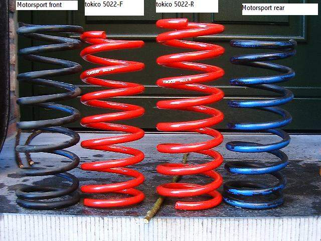

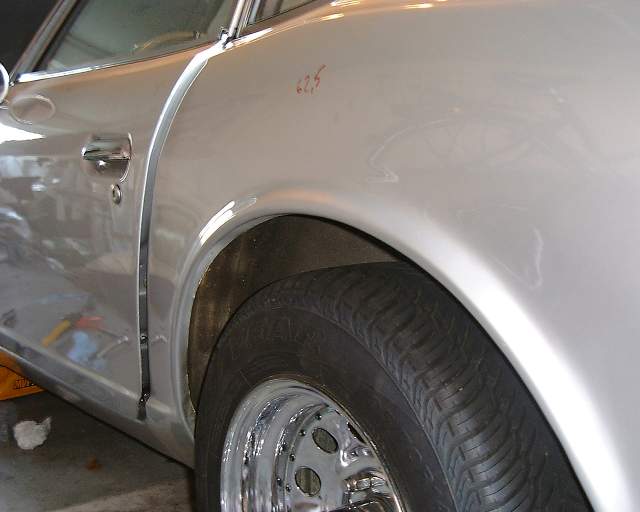

Posted December 9, 200420 yr comment_104615 Hell friends. At the moment I try to install a new suspension because auf problems with the old one. But the springs whill not not realy fit Old: - stock shocks, no cartridge. - blue MSA Springs (told by preowner). - rear strut not enough rebound, when wheels are free from the ground, the sprong had about 1 inch play. - The car was on his maximum lowered, because the was not much working space left till the bump stopper get in contact. Distance to the ground (edge of fender) 64,5cm Front and 62,5 rear. Now my new tokico illumina's and springs: Rear: rebound nearly o.k 5mm missing. Front: the strut rod is about 3cm too long, on the picture you can see that the sprong is about 1 cm shorter. So the new strut must be longer. Distance to the ground (edge of fender) 68,5cm Front and 67,5 rear. That means +4cm front and +5cm (+2"). that looks like a 4 wheel drive. I'm sure that I missed not parts,or swapped them. parts: springs 5022 F and 5022 R Strut BZ3012 and BZ3013 - My car is a european version, much ligther than a us version. - The new strut whill allways expand, does this force push up the car ? Has anybody ideas for me ???? Thanks for your attention Rainer Link to comment https://www.classiczcars.com/forums/topic/14265-tokico-254-suspension-kit-tooo-high/ Share on other sites More sharing options...
December 9, 200420 yr comment_104639 I dont really know waht you mean, butNow my new tokico illumina's and springs:Rear:rebound nearly o.k 5mm missing. No idea, sorry I dont understand what you mean.Front:the strut rod is about 3cm too long, on the picture you can see that the sprong is about 1 cm shorter. So the new strut must be longer. Unless you have coilovers you cant adjust the strut length.If the springs are a stiffer rate (they look fatter so they probably are) then they wont compress as much, so they could stit at the same hieght as a weaker spring of a longer unloaded height. which is probably why they are shorter.Distance to the ground (edge of fender) 68,5cm Front and 67,5 rear.That means +4cm front and +5cm (+2"). that looks like a 4 wheel drive.I'm sure that I missed not parts,or swapped them.parts:springs 5022 F and 5022 RStrut BZ3012 and BZ3013 The rear should looked too low in the photo. The rear should be the same if not more higher than the front. shouldn't it.- My car is a european version, much ligther than a us version. US and European 240z should be the same weight. Unless you got springs for a 280z. that might make the car ride higher as the 280z is heavier isnt it.- The new strut whill allways expand, does this force push up the car ? Yes, springs are designed to push the car up off the road. The stiffer the spring the higher it will sit (shock cartridge length has nothing to do with the ride height of the car, unless you put in ones that are way too short).Has anybody ideas for me ????Thanks for your attentionRainerMaybey you ordered 280z springs. Maybe you ordered standard ride height springs, instead of lowered springs. Maybe you ordered extra stiff springs.Check with the manufacturer.Have you got photos of the car with the new springs? Link to comment https://www.classiczcars.com/forums/topic/14265-tokico-254-suspension-kit-tooo-high/#findComment-104639 Share on other sites More sharing options...

December 10, 200420 yr Author comment_104747 Hello to all, I made some pictures and it will clear my story. I twisted the the names strut and shocks before. That will confuse. :stupid: I will not say that the old MSA springs are worn,because they were installed short before I bougth the care, so that mean 10 k miles. But the new springs don't fit nice because : -he care is too high, -The uncompressed spring is to short, or the strut is too long. On the front about 3cm rear abou 5mm. This will give problems with the german laws and coil over is not allowed too for road use. Possible solutions: -Get other springs from Tokico, but I bougth them in USA and ship them to germany. That's not so easy. - install the shorter strut mounting isolator from a front on the rear side too, than I'm about 1 inch deeper. But for the front ???? Has anybody a service contact adress from tokico USA ? Cheers Rainer Link to comment https://www.classiczcars.com/forums/topic/14265-tokico-254-suspension-kit-tooo-high/#findComment-104747 Share on other sites More sharing options...
