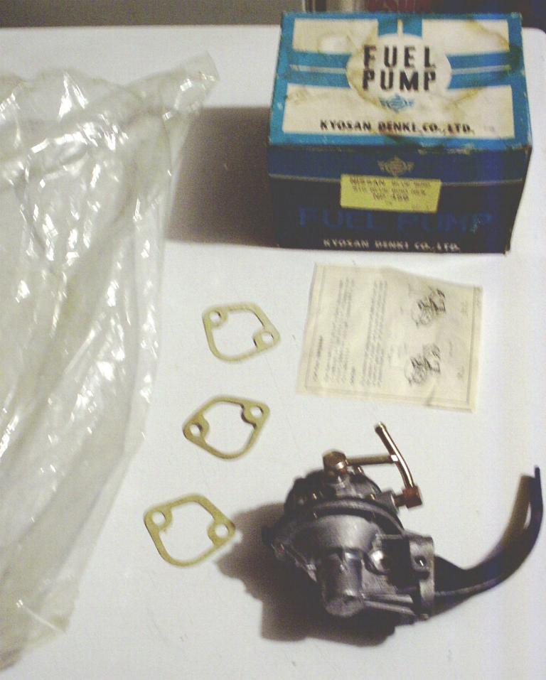

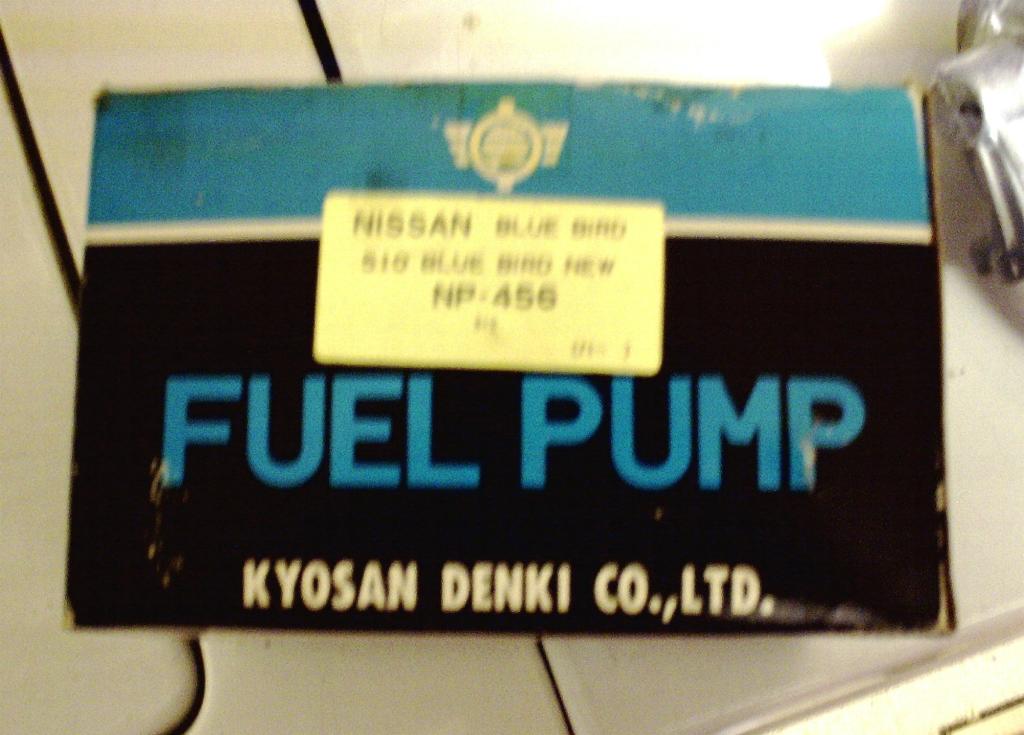

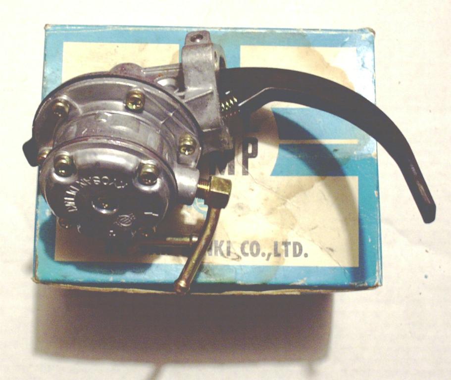

d***, I have a mechanical fuel pump if you're interested. It's brand new in that it's never been installed on a car but I've had it laying around amongst my parts for so long I don't even remember where I got it from. It was made by Kyosan Denki Co., Ltd. It's in the box still wrapped in plastic and has three gaskets and a little info sheet printed in Japaneese and English. It is, however for a four cyl. The box says 'NISSAN BLUE BIRD 510 BLUE BIRD NEW" and it's part number is NP-456. Is there a difference between the 4 cyl and the 6 cyl fuel pump? If this is something you can use let me know.
