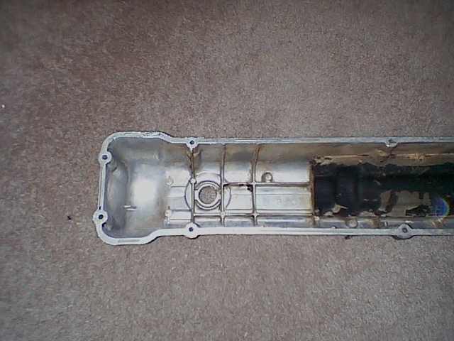

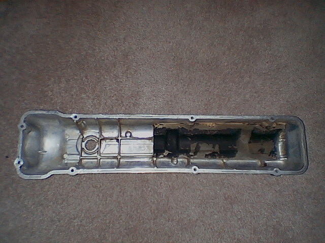

Ok.. well I decided to just splash in some AirCraft stripper and a toothbrush...
after about 5 minutes.. Look at my new valve cover!
I also painted it!!
Anyone like it!!
Hopefully you got ALL of the stripper out of the Valve Cover (including any that seeped under the metal plate covering the back 1/2 of the cover) cause it is extremely caustic stuff and would EAT any seals it comes in contact with in a heartbeat.
aircraft stripper is a really powerful chemical available at your local auto store, or Wal-Mart, which basically strips anything and everything off of metal...
used for removing paint from cars and stuff.
But be very careful! it ate through 2 layers of rubber gloves, and disintigrated a plastic brush I had...
very strong stuff... but does miracles!
I used Dupli-Color Textured Metallic coating.. also available at nearly all auto stores
