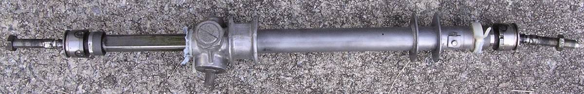

I am going over my rack too. I have cleaned all of the grime off, and performed a precursory wire brushing. I noticed two(see the picture) 6mm bolts(8mm heads) covering passages that are for grease. After I strip and paint the housing, and relube the bare metal that moves through the rack, I will install two 6mm grease fittings, and load them up with grease. I am replacing the tierod ends, but it looks like someone had either kept the balljoints and rack well lubricated, or had replaced both in relatively short mileage-no wear on either!
Will
Here is the Rack ready for paint.
I cleaned it, taped off the lubricated parts(tiewraps are in the pictue)
beadblasted the housing, and then treated the housing with metalready.
I am going to clean out all of the old lubricant(to make sure any glass bead that may have gotten in the mechanism is gone) with mineral spirits. Then I will wipe down the housing with laquer thinner, tape up everything again, and paint(POR15) the housing. When the paint has dried, I will prelube the mechanism, replace the 6mm bolts with grease fittings, pump some grease through to make sure the openings are not blocked, install new bellows, and fill each side with grease at its minimum adjustment(so I don't have grease squirting all over when the steering wheel is turned lock to lock for the first time.
When I install it, it will be acompanied by urethane!
Will

Note that some parts of the steering rack are aluminum. POR doesn't really like to stick to aluminum, at least that's what I found when I did my rack. I left it painted anyway but it'll probably peel fairly quickly if it gets worn. I'd recommend using POR on the steel but either leave the aluminum bare or clear-coat it with spray paint. Here's a (bad) pic of my assembly, also with poly and new boots. Damn I miss workign on my z...
