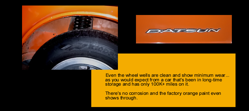

I agree with Carl, one picture of the passenger front wheel well almost shows a patch panel behind the tire(under battery area), but man oh man those floors pans look great!
Which picture is that? I see what looks like a patch panel in a couple of pictures of the right rear wheel.
MikeW:
Unless you are seeing something that I don't, I believe that the panel you are refering to in the RR wheelwell is the original Access panel for the filler hose. (The one I sent you a pattern and pictures of last summer when you mentioned that your car was open in that area.)
MikeW:
Unless you are seeing something that I don't, I believe that the panel you are refering to in the RR wheelwell is the original Access panel for the filler hose. (The one I send you a pattern and pictures of.)
I'm referring to the attached picture from the eBay ad.
Me too. 2nd and 3rd pics are of the panel on my car.
Wow, you're right. I'll have to go back and look at my car. I didn't realize it wrapped around that far. I guess since I've gone without that panel for so many years (and haven't gotten around to fabricating one from your template) that I didn't know what I was looking at.
