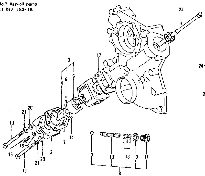

I believe the offset key, you are referring to, is on the receiving side of the distributor. However, the other side is a shaft with a gear on it. After looking at the microfiche CD (shameless plug), I can see that another key may exist on the bottom side. This key is used for the oil pump?
Anyway, if the oil pump is running 180deg out of whack I don't believe it would be a problem either. So, I'm thinking the shaft was put in with the wrong rotation.
See the attached snapshot of the microfiche part #22.

The driveshaft that operates the oil pump and the distributor does have an offset tang to it which should be in a specific orientation. When it *is* in the correct orientation, the distributor can only be installed in the correct orientation.
HOWEVER, the driveshaft *can* be installed in any orientation (i.e. it will "fit" in any orientation) that someone cares (or more accurately "doesn't care") to attempt. If this driveshaft is installed wrong, the distributor will be trying to fire the cylinders at the wrong time in relation to the combustion cycles of the cylinders.
