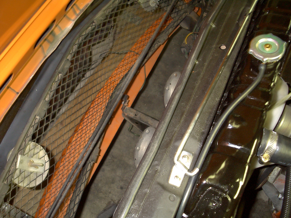

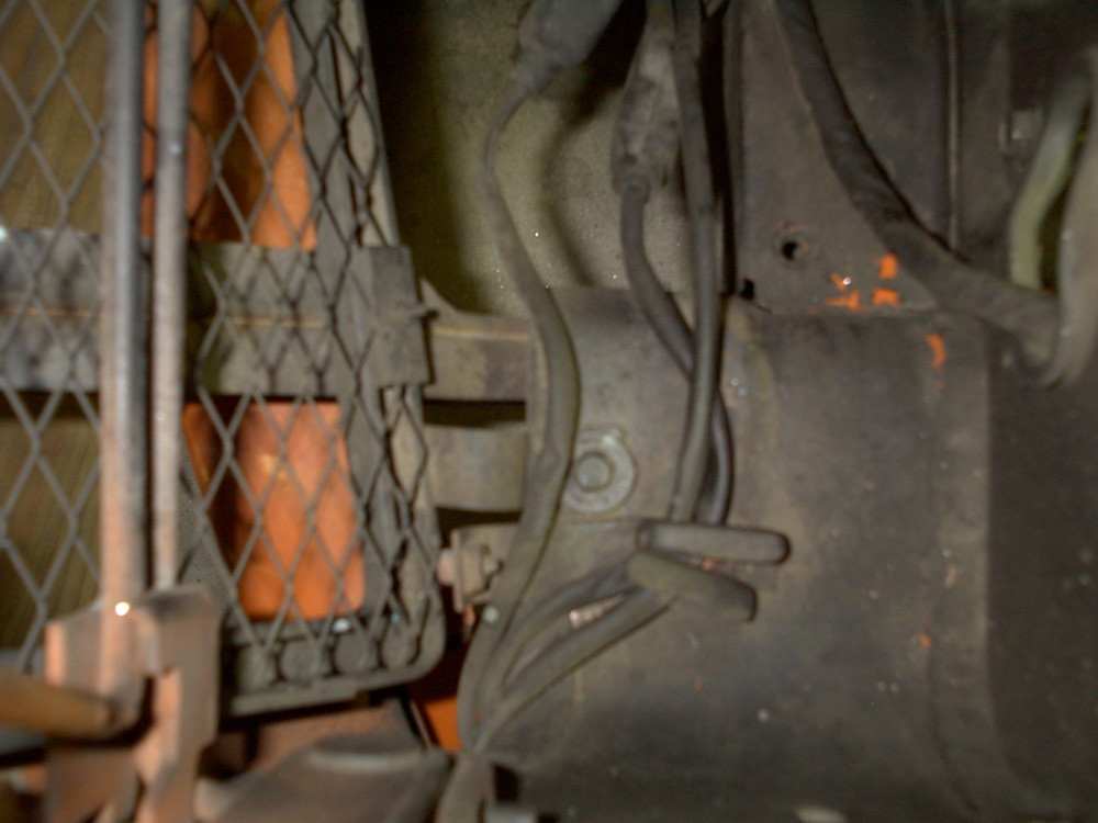

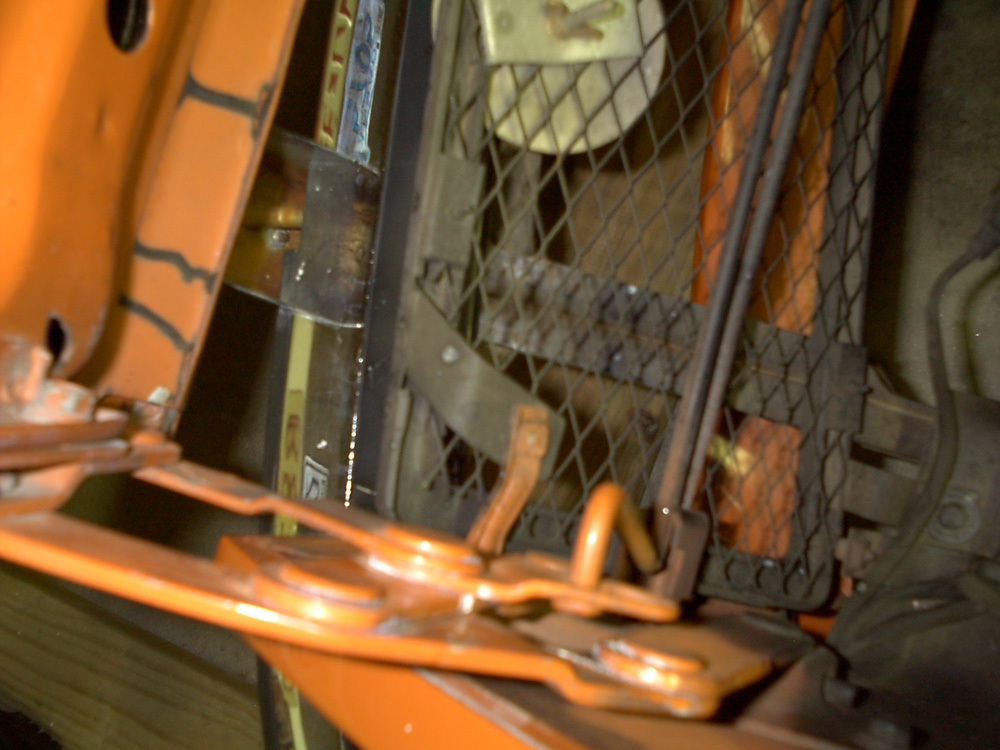

I am pretty sure this is a 240 grill…. I have one and it does require a little bit of modification to get it to fit on a US spec car. Nothing serious or major. The center attachment is dead on, the two top ones have to be bent slightly at an angle but that is a no brainer. (I cannot tell from the Ebay picture if the top ones are already bent, they very well may be). For the two bottom attachments you have to drill through the panel in order to secure it. I did not use the 240 mounts. If you like, I can try to take some pictures of it mounted for you. I much prefer it to the stock grill but then again everyone has different tastes…. Thankfully….and… as far as it being frail…. I have only had mine on for 26 years and she’s as strong as the day I put her on…..
Ok, I have wrestled with getting pictures in here long enough....I still have no clue how to do it.
So, there are three shots in my photo gallery.... Center photo shows how that aligns up perfectly. Top; you will notice that the attachment is slighly bent. Bottom, you will see a bolt between two wires... this is were I drilled the panel.
