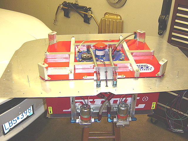

The 15 gallon install was more "show" and made from 1 x1" and 1 x 2" aluminum and was a bolt in (and rivit in) type of install. I will attach a photo, sorry I can't find my old car photos of the 22 gallon.
