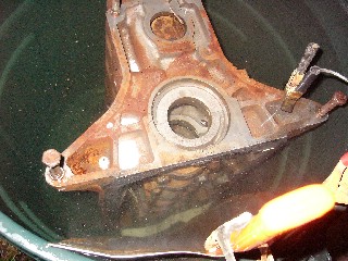

There's your answer! Turns out an L24 fits perfectly in a 30 gallon garbage can! I'll get you some after pictures in a few days.

Yes, I have practiced on smaller items first--it will work. OK, you are right--you have to have a battery charger ($25 or so?), electrode(s) ($5 maybe). Evaporust's product comparison chart says you need $60,000 to do electrolysis. That must be some fancy battery charger!
My garbage can is plastic. I don't think there's a chance it will turn into an electrode and dissolve.
