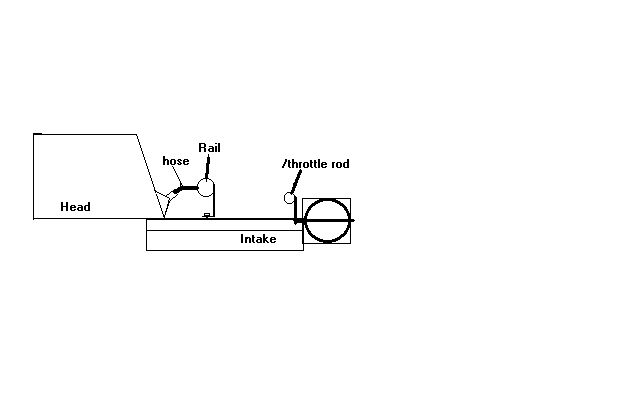

I had an idea about mounting the new rail down the length of the intake, close to the injectors, keeping it low to the intake, with bent fuel hoses. (pic below) Can it be done?
Also, I noticed there's a (plastic) insert in the head where the injector tip goes in. It's a snug fit. Do you have to replace those? I don't see them in any catalog. Is that the "o-ring?" There's a tiny little hole in it, so I expected a bigger hole.
Now, I can either send out the injectors to get serviced, or just clean up the intake with some solvent & start reassembling things.

TomoHawk,
The plastic insert is a filter, they are not ment to come out, but can be removed if you are careful. That filter is the reason I back flush my injectors-it keeps crap form deteriorating lines and surfaces out of the pintle, meaning the only thing that can block the injector is a deposit from the fuel, and Carbureator cleaner is designed to disolve what-deposits from fuel! Back flushing empies the filter.

It doesn't look like a filter to me. Just a hard plastic thing with a little hole in it. The hole is smaller than the pintle even. I'll just clean it out with a little carb cleaner when I put the injectors back in.
I know there's a little fuel filter in the Injector at the top. I'm just a little confused, because there's supposed to be a rubber o-ring on the pintle end of the injector, and none of my injectors haved them. I've been looking at my FSM files, but it's slow reading.
thx any way.
