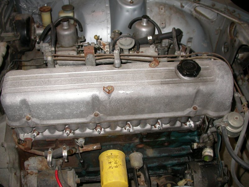

Just a quick question. The elbowed nipple on top of my valve cover is screwed.
As you can see....the hose it pushed all the way up against the cover because of the missing section. Anyway....in my search for a valve cover, I am not noticing any with the "2400" on top. All I see are the "Nissan OHC" ones. No big deal, just wondering which years had these. Picture below.

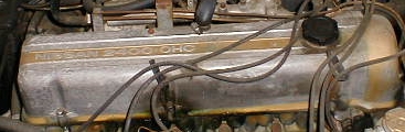

The "2400" valve covers are early 70-71 covers. After that they changed to the Nissan OHC. I'd guess, although I could be wrong, that someone replaced yours, if the car is the '72 in your sig. By 72, I think it would have been the Nissan OHC cover. I've attached a pic of the VC off my '70 car.
You might sell the cover on here or eBay, because many people with the early cars are looking for them. Let the new owner fix the elbow and you could go with the Nissan OHC cover that the '72s came with. Or keep it because it is unique. I have one because my car has a 12/70 build date, but even if I replace the (non-matching) L24 with an L28 I think I'll keep the 2400 cover anyway.

Well....according to my engine number, I found out from a previous post that its not a 72 engine. The engine number is L24 008107. Carl sez that should give it a birthdate in the neighborhood of 6/70, which would explain the E31 head, and probably the valve cover. If I can locate an elbow....I will just keep it. Was just wondering why I was not seeing any similar valve covers. Thanks for all the input. Now I'm off to find an elbow.
Zthing,
You have an early engine in your car and I was going to mention it in the other thread. The 2400 valve cover is not very common and usually sells for over $100 on eBay. I would recommend repairing yours with parts from the more common OHC valve cover. Also, your engine should have the eight counterweight crankshaft http://www.classiczcars.com/forums/attachment.php?attachmentid=4959 which is nice. Evidently someone took your original engine out and replaced it with the earlier one, probably not realizing what they were doing. In my opinion your engine is more valuable and I would recommend keeping it in good repair.

I would definitely keep the 2400 VC…. They are getting hard to find and it would be well worth the fixing and polishing (if I may add). I get lots of compliments on mine simply because its different.
