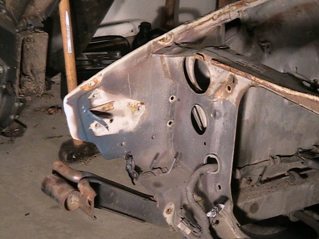

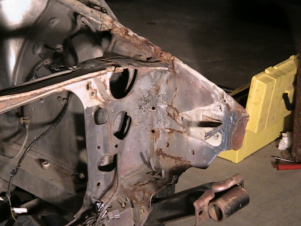

Posted March 27, 200519 yr comment_118589 As the Z car got smaller and smaller as I am disassembling it, it became clear to me that she has been in a few minor accidents over the years. The passenger side floor board is raised up and dented upwards. Really I am writing this for any opinions on another are of body damage The front left of the car has been damaged, spanning from where the headlight scoops mount to the crossmember, which is also bent. Look at the photos. The cross member circles also became misconstrued. I realize it is not very major, although if I am getting the car painted and am spending this much time to make retstore it I want it to look the best possbile. I know that replacing it would be overkill, so my next best bet is to make it look the best I can. Thanks in advance to all who offer opinions. The first photo is the undamaged side Link to comment https://www.classiczcars.com/forums/topic/15459-frame-damage/ Share on other sites More sharing options...
March 27, 200519 yr comment_118595 Take that car to a frame shop and have them chain / block the rest of the car and then straighten the front end back out.What you have is the result of a collision with an object on the lower left corner of the frame "cube", causing that corner to come up and in towards the center. Even though the metal has been "straightened" you can still see the twist in the frame from the front picture.Get the dimensions from the FM for that year if they don't have them available. They'll chain and block your car, and then using hydraulic rams, will pull that corner back down and out.The frame shop will pull out the twist and allow you to properly straighten the metal there. You'll probably notice the roundness in the vent holes comme back on it's own.2¢Enrique Link to comment https://www.classiczcars.com/forums/topic/15459-frame-damage/#findComment-118595 Share on other sites More sharing options...

April 6, 200519 yr comment_119649 Fixing damage like this is risky on a 30 year old car. I would suggest inspecting the frame rail back and underneath the floor pan for any crinkling where the frame rail has been pushed back into the body as well. Track down someone who has experience with these cars, or foreign cars at least. Repairs can run from a few hundred to a $1k+. Be sure that who ever is pulling out the damage has dimentions of the original car. Since this car is 32 years old it is likely that most shops will not have the correct measurements and you will need to supply them with that information.Finally, be sure that this is the chassis you want to restore. I had a 70 that I was going to restore originally, and elected to buy a replacement chassis instead. To do a full restoration, you will want to start with a good foundation. Link to comment https://www.classiczcars.com/forums/topic/15459-frame-damage/#findComment-119649 Share on other sites More sharing options...

April 6, 200519 yr Author comment_119652 Well when I went up to this shop he had 2 Z's sitting in the parking lot which got me excited, they were probably a 78 and an 81 or so. So he has had some Z experience, I don't know how much though. I'll have to ask him.As for the extent of the frame damage it appears only to be on the front right corner. I looked at the frame and it had a couple dings from junky jacks lifting using the frame, that is all it seemed. It looked decent. Although I did say this. On the passenger side the floor is raised up (an anti-dent if you will) I do not know if this was the same accident or not. So I'll have the frame man asses this.I had been saving for a paint job, but it looks like this will have to come first :mad: Ron I wish I could just start with a new chassis like you did, but I am just a student in high school and can't cut the money for that. Plus the more I feel like I got ripped off on this car, I just couldn't do that. The whole thing just makes me angry Link to comment https://www.classiczcars.com/forums/topic/15459-frame-damage/#findComment-119652 Share on other sites More sharing options...
April 6, 200519 yr comment_119654 My car had almost the exact same damage. I had it straightened at a frame shop. I don't remember the exact cost for that part but it was around 2-300 dollars. They basically had to pull it 2 directions, toward the front and toward the left to get it to pop bacfk into place. I had a few other things done at the same time so I can't remember how much it was exactly. It was very difficult to find a shop to do it. I had to go to 4 or 5 places before I found the right place. It looks very good now, but I'm not happy with the other work they did (welding new dogleg panels in and repairing a rust hole in the firewall). I should have had them fix it but I didn't notice how bad it was till I got it home. Doh. Good luck finding a shop.Michael Link to comment https://www.classiczcars.com/forums/topic/15459-frame-damage/#findComment-119654 Share on other sites More sharing options...
