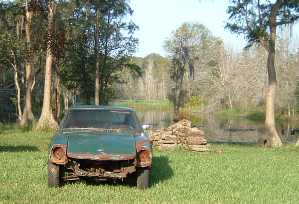

April 19, 200519 yr Author comment_120997 for some reason no matter what i try i cannot get the front two fenders off ive tried everything... and the majority of the bolts ive taken off have just snapped and im a little worried about taking anything else off... what should i do Link to comment https://www.classiczcars.com/forums/topic/15641-imlost/?&page=2#findComment-120997 Share on other sites More sharing options...
April 19, 200519 yr comment_120998 for some reason no matter what i try i cannot get the front two fenders off ive tried everything... and the majority of the bolts ive taken off have just snapped and im a little worried about taking anything else off... what should i doBuy a can of PB Blaster , this stuff really works well on rusted bolts. Spray it on and let it set for a while , it badly rusted over night . Good luck Gary Link to comment https://www.classiczcars.com/forums/topic/15641-imlost/?&page=2#findComment-120998 Share on other sites More sharing options...
April 19, 200519 yr comment_121004 There have been a lot of threads in the past about favorite penetrating oils. The Marine / boat industry has some interesting stuff. PB Blaster is my favorite along with Kroil. Link to comment https://www.classiczcars.com/forums/topic/15641-imlost/?&page=2#findComment-121004 Share on other sites More sharing options...
April 19, 200519 yr comment_121006 Have you taken out all of the bolts-the row at the top, the one in the door opening, the two under the Valence Panel(covers the windshield wiper mechanism), and the two at the bottom?There are also those that hold on the headlight bucket(behind the front grill)-if you haven't taken it loose from the fender(3 nuts in the wheel well)-careful of breaking the studs!Obviously a service manual-or the Club CD-would be invaluable in knowing what is holding all of the stuf on!WillPS. PBlaster works very well, but it stinks-don't sneak out to the car to spray something right before a date! Link to comment https://www.classiczcars.com/forums/topic/15641-imlost/?&page=2#findComment-121006 Share on other sites More sharing options...
April 19, 200519 yr Author comment_121030 thanks alot i dont think i could have found a more helpful website, you guys are really nice and know what youre talkin about i hope you can handle all my questions through my restoration... haha Link to comment https://www.classiczcars.com/forums/topic/15641-imlost/?&page=2#findComment-121030 Share on other sites More sharing options...
