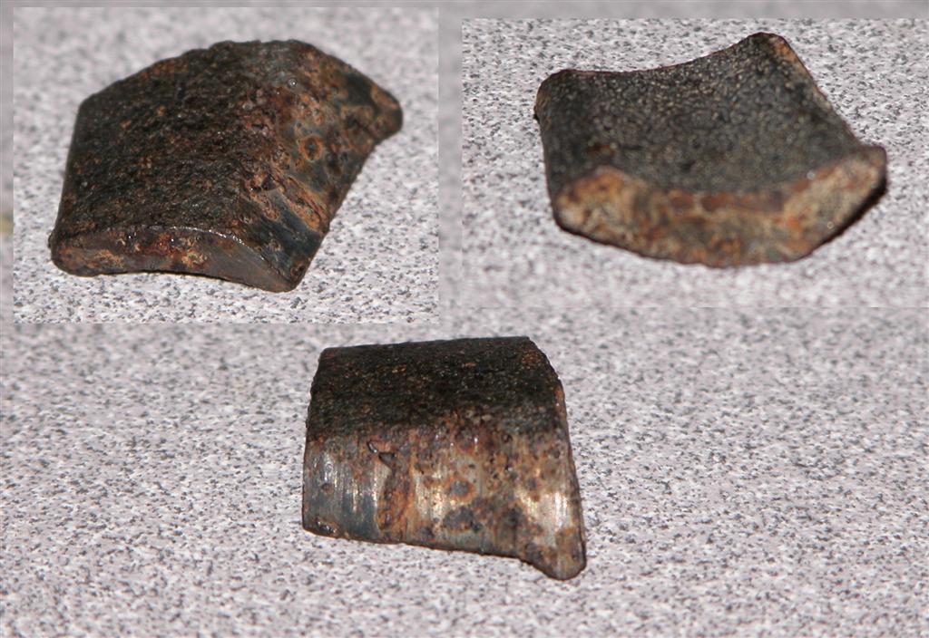

April 30, 200519 yr Author comment_122180 Well, today I pulled the water pump and timing cover and I can't see any sign of corrosion or a leak. I pulled the block and while turning it over on the engine stand with the head off a piece of metal fell out of one of the coolant passages. I've attached a picture with several views of it. It's approximately 1/2" x 1/2". Given I haven't found any obvious sources of the coolant leak and now having found this piece of metal, I'm very suspicious of the block. I'm looking for suggestions on what to do next. Link to comment https://www.classiczcars.com/forums/topic/15647-coolant-in-the-oil/#findComment-122180 Share on other sites More sharing options...
April 30, 200519 yr comment_122181 Before you took the head off did you check the torque (in tightening direction) of all the head bolts? Any less than spec?Did you inspect the head gasket for signs of water leakage from coolant passages into the cylinders?Is the photo showing 3 views of one piece or 3 views of 3 pieces? Is your pump impellar intact? Pieces look too hefty to be from impellar? Link to comment https://www.classiczcars.com/forums/topic/15647-coolant-in-the-oil/#findComment-122181 Share on other sites More sharing options...
April 30, 200519 yr Author comment_122185 Great call Kinfish, the piece is from an impeller, although this one is complete. I'll guess the PO had one fail and this one is a replacement. So I feel a lot better about this right now.As for the head bolt torque, I didn't check them before loosening, but they did seem to come off easier than the previous times I've removed them. I just don't know how much of that could be due to having used anti-sieze on them.The head gasket looks perfect. I've gone over it several times and I just can't see anything wrong with it. It was only one for a few thousand miles and it looks practically brand new.I'd like to think the coolant leak was due to the head not being torqued down enough. I'll be taking the head in to check for flatness next week.So my question remains if I should just reassemble, or what? Link to comment https://www.classiczcars.com/forums/topic/15647-coolant-in-the-oil/#findComment-122185 Share on other sites More sharing options...

April 30, 200519 yr comment_122188 The piece or pieces have airfoil shapes that appear to have fractured from the rest of the airfoil or root (cannot assess the size of the pieces from photo)., If they are large they may have been from a pump impellar.Anti-seize compounds do not cause head bolts to become loose. It is critical to insure the mating threads on the bolts and block are clean and free of burrs so you don't consume spec torque trying to overcome friction. You should chase the treads on the block with the proper size tap prior to assembly. The compound is used to minimize corrosion which can lead to excessive breakaway torques and possibly fracture of the bolt. When the final increment of spec torque is applied it creates a preload in the bolt which is the mechanism that prevents the bolt from becoming loose during operating conditions. If your problem was a leak at the head interface, several scenarios may be culprits:1) If the bolts were original you should have replaced them with the later turbo head bolts which are improved material and have higher final torque (nominal of 55 ft-lbs).2) Your bolts may have sustained permanent elongation since the last head removal. They eventually yield after many cycles of time and temperature. When they yield you lose preload and eventually they will become loose in a worst case.3) Your torque wrench is out-of-calibration.4) You consumed a portion of the desired spec torque overcoming friction due to dirty or burred threads. This causes preload to be less than optimum.5) You should torque the head in increments per the sequence in factory manual and do it only when it is bone cold.6) You should retorque the head after running engine for several hours since head gaskets compress and you may lose preload.Did you comply with these guidelines on the last head install? I would keep looking for other sources of leaks before you give up and throw it back together. Link to comment https://www.classiczcars.com/forums/topic/15647-coolant-in-the-oil/#findComment-122188 Share on other sites More sharing options...
