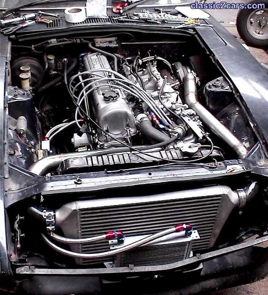

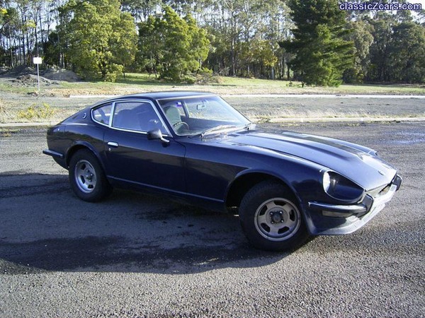

I have a navy blue 240Z that I purchased from a friend of a friend.
Originally brought with blown head-gasket I drove it with the stock L24 and flat-top SUs (
) until the SUs decided to develop a flatspot from between 1% and 80% throttle. Holding the throttle anywhere inbetween those two resulted in massive overfueling, a black plume of smoke three lanes wide on the freeway, half a rear muffler and a subsequent police detective motivated pull-over.
After several trips to Ballarat going 100->110, clutch, roll, repeat, I sourced a supercharged L28 replacement. After some clutch dramas during the install I drove the car like this for 6 months or so while I gathered together parts for a turbo conversion.
Then 6 months ago (ok so it might be more than 6 months), after breaking the gear selector linkage on the 280z 5-speed in there I took the car off the road to do the conversion.

Car:
Model: 240Z
Year: 1973
Colour: BMW Navy Blue (crows feeted to hell)
Front bar: Not standard (?)

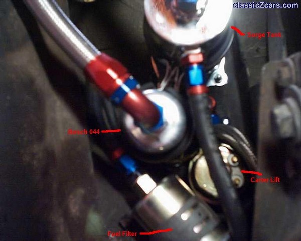

Fuel System:
Tank: Standard
Lift pump: Carter 110gph
Surge: CM510 alloy around 1-2 litres
EFI pump: Bosch 044
Fuel feed line: dash-8 (1/2" ID) line
Fuel rail: custom
Injectors: 460cc N/A S5 RX7
Regulator: Bosch adjustable rising rate

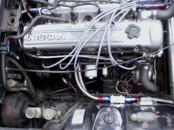

Control/Ignition:
Type: EFI - fully sequential injection
Computer: Autronic SMC v 1.91
Distributor: Custom hall-effect
Leads: Sorcher 8mm induction
Coil: Bosch 716HEC transformer type
Ignition Module: Bosch

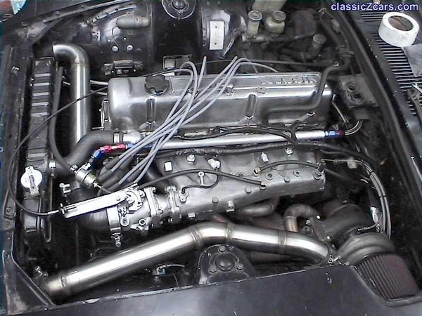

Induction:
Manifold: Standard 280zx EFI
Throttle body: Ford XF Falcon 65mm
Piping: 2.5" stainless
Intercooler: ARE 520x300x90 bar and plate
Turbocharger: 620hp Garrett GT35R (0.82 turbine housing)
Exhaust:
Manifold: Custom Ian Rowlerson: stainless, tigged, tuned length, split pulse collector, external wastegate flange
External wastegate: Sub-zero 55mm
Exhaust: 3" mandrel bent mild dumper to 2.5" press bent street system and 3" side exit race system. 2.5" screamer off wastegate
