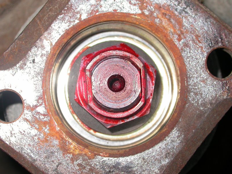

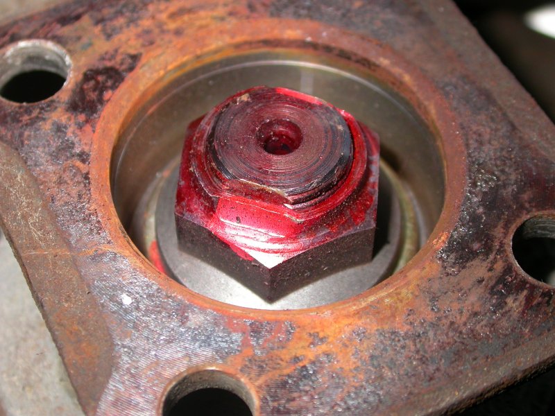

You could attach a steel plate to the bench top with through bolts. It could be drilled to match the 4 bolt stub axle pattern. Drop the assembly on top of this and wrench away. The hammering of the impact is what aids in the nut removal. If you don't remove the nut peening the stub axle will likely be ruined and the 280Z stubs are favored for strength and getting harder to come by. Take the time to prep the nut and it will be easier.

The torch idea is easy to try. I used heat to get the tie rod nuts loose on the front end a month ago. Maybe cutting the peening off, heating up the nuts and using the good old dime store air gun will do it...if not, nothing lost! I shall try that first before setting up a "torque station" on my bench.

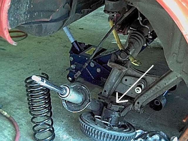

Can you post a pic or the part you're removing? I'm about at the same spot and wonder if I just made the same mistake (it's been a few days since i've worked on this and intend to finish the tear down of all the remaining rear suspension bits Fri night...
Larry, I drew an arrow to the location of the nut we're discussing.
Chris
Chris has pointed out where the nut is, and here are a couple of close-ups for fun! The first is at an angle so you can see the "peening", and the second is from above so you can see how it is crimped to the flats nicely.
