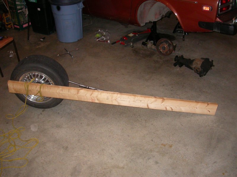

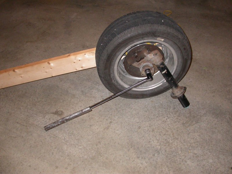

Well, thanks for all the ideas! I cut off the peening as panchovisa admonished me to do (thanks), used a torch per ChrisA, and then set up a rig of my own invention, but from ideas of a bunch of others. The dime-store air gun was still a bust, but a 3 foot breaker bar, with an 8 foot 2x6 tied to the wheel worked like a charm! I didn't even have to break much of a sweat! One helper on the tire, and one on the other end of the board to keep them from tipping, and I broke it loose in just a couple tries.

great bit of improvisation:classic:

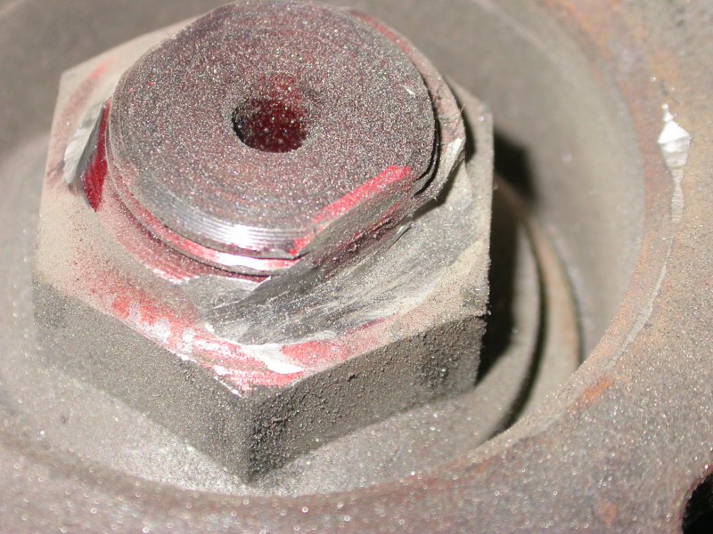

If you look at one of my posts above, you'll see pictures of the nuts before I cut off the peening. It is essentially the top edge of the nut bent in against flats on either side of the axle to 'lock' it in place.
By cutting it off, the threads on my axle are now still in perfect shape. I don't know what it would do to the threads by not cutting the peening off. The factory manual says not to cut it off, but several members here have insisted that it should be done (and it worked for me!). I was VERY careful with my dremel not to get into the threads while cutting.

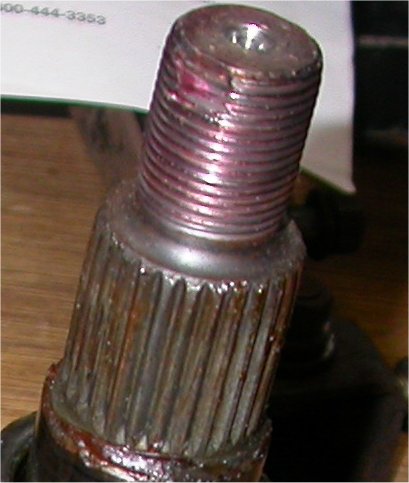

Mark: I was wondering about this. It looks like the threads on the stub axle have been removed by the cutting. Is this an illusion? I am trying to gather as much information on this job as I possibly can as I am sure I will have to do it one day in the future and I want to understand what to do and not to do when the time comes.
Carl, the axle has two flats milled into it which removes the threads there. The nut has an un-threaded "collar" which is deformed to match the flats AFTER the nut is torqued.
When you try to remove nut without grinding off deformed area it screws up the last 4 or 5 threads on axel. When the real nut portion is un-screwed past the buggered axel threads they are also ruined and make it almost impossible to get a NEW nut back on (remember old nut is destroyed with/ or without grinding of crimp!!!!). Please sacrifice the nut to save the axel!

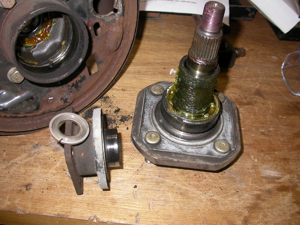

Here's a picture of the flat on the axle end. There is a matching flat machined on the other side of the axle. Also a pic of the axle removed from the strut for reference. If you want any better pics, now's the time to ask! It's all apart!
