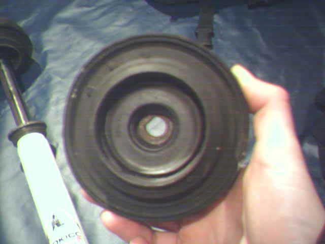

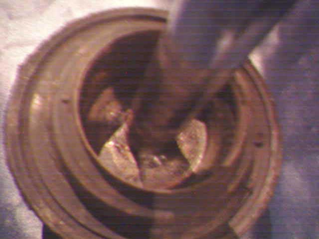

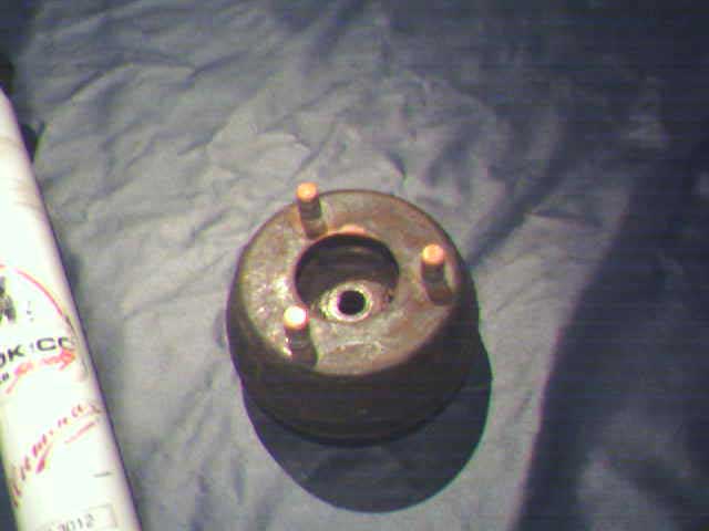

With the struts I got the guy included the rubber insulators that go into the top of the shock towers. Is this the part I need from a 260z I've included pictures of it below.
Looking in the Haynes manual it appears they are slightly different I think i can see the part I need.
I think I'll be right if I buy the boots first take a look at them and see what's going on with them. I know the guy who owns a wreckers here who will probably have what I need. I've also got a friend who has a little workshop and he will have a solution i think.
This is the first one with a small rubber washer part not on the other 3 I have.
The other has no inner ring in it not sure if this is the part that the boot connects to?
The final is an external shot just for comparison sake.
If I'm understanding what you have, the "rubber washer" is a spacer for the rear struts only. On the front struts, there is a bearing that fits in this place you seem to have indicated. And these parts are not where the rubber boot would attach. On the strut, you have the spring, the upper spring seat, the bearing (or rubber spacer), and then the big rubber top mount with the three studs. The boot fits around an inner lip on the upper spring seat. Hope that's clear... :(

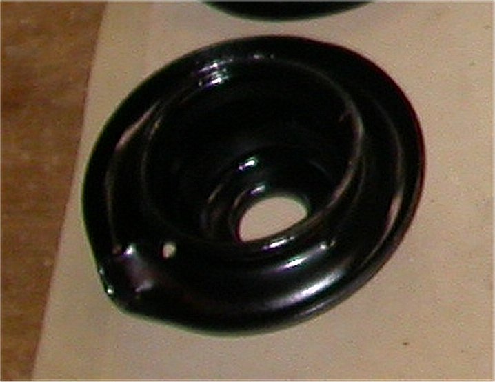

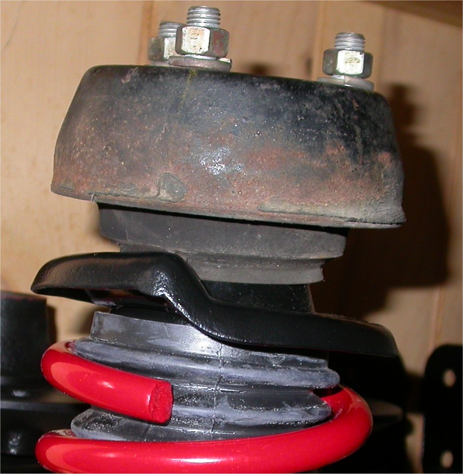

I just put a set of the OEM style strut boots on my 280Z, so FYI, I've attached two pics: one that is the underside of the upper spring seat where the boot fits around a lip, and the other with the boot installed on the strut. I haven't disassembled my 240Z struts to compare, but these are 280Z style.
