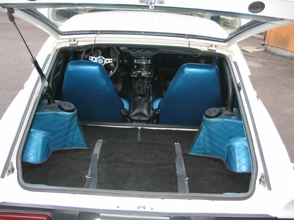

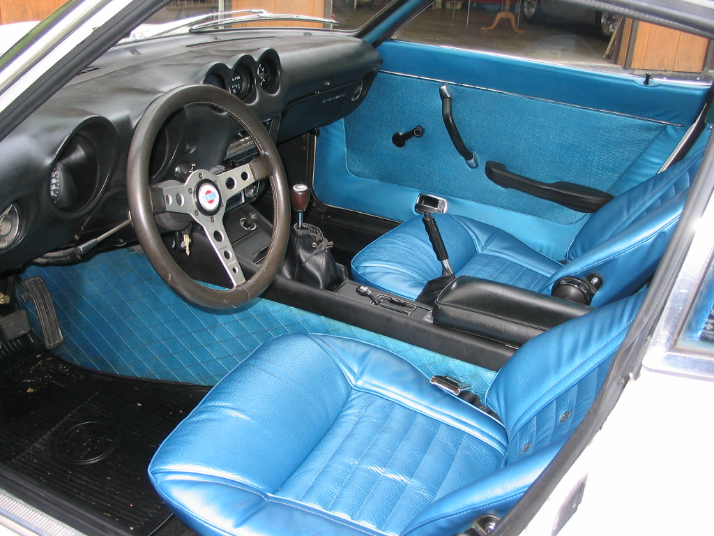

I also happen to have a blue on blue '70. It is both a blessing and a curse. The blue interior is very rare, so you don't see many around. But trying to get original parts for it is nearly impossible. If you don't have to have Nissan parts, then best place to get aftermarket replacements is Classic Datsun: http://www.classicdatsun.com/ They were one of the original shops hired by Nissan to perform restorations on the Classic Z-Car Program. They carry the interior plastic panels, seat covers, and diamond vinyl. Maybe the headliner too.
Getting door panels is next to impossible. I have owned my car since 1998 and still have not found a new blue drivers door panel. I bought a black one and dyed it blue to match with SEM vinyl dye, great stuff. I can send you instructions on how to do it if you need them.
Visors were blue, carpet was black.

Post some pictures. We always like to see pics of a new member's car. You can check my gallery to see mine.

I am pretty sure Les has the door panels too.
http://www.classicdatsun.com/new/240_interior.html
He prefers to install them on your panels but I think you can have a local shop do them for you. He has the correct blue to match the seat covers and replacement panels in the hatch area. I have already picked up his replacement 6 piece replacement panel set.
