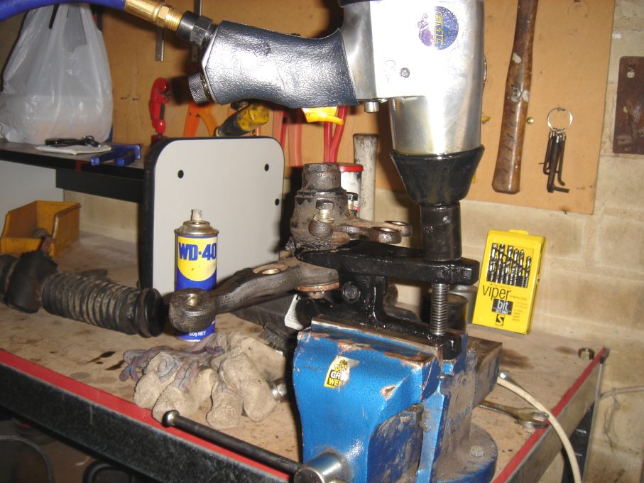

I used a ball joint seperating tool which had two fingers which locate on the knuckle and a opposing third finger which pushed the ball joint through by winding a bolt on the opposite side. Worked great for the ball joints, popped them right out after sufficient pressure/winding. I used this tool as I could not find the pickle forks which seem to be so popular in the states.
I also used this to seperate the outer tierod joints front the knuckle but not without destroying the tool as they were well and truly seized. The head of the bolt sheared off the tool before the joint would pass though, however the tool, firmly clamped in place made an excellent striking point for the BFH, which did the job in the end.
I bought one similar to this years ago, and it has been worth its weight in gold to me. It is also the most requested tool by far to borrow by my fellow car nuts. I never had any success with the pickle fork type, although others obviously have.
Only problem I have found is when a seized 30 year old ball joint finally lets go when using the '3 finger' type it tends to go with a bang and you can get hit by flying tools/balljoints.

Here is a pic of what I used as described above, no heat was required where as the tierod ends required an oxy torch at a suspension shop to get them glowing before they would move on the rack thread.
