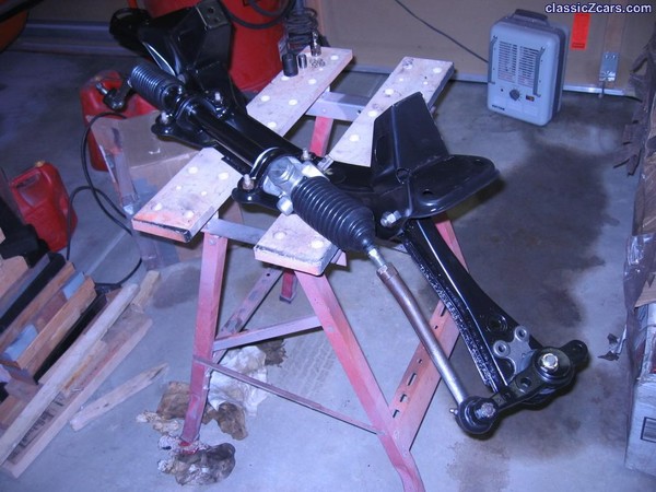

July 19, 200519 yr comment_131166 Quick question. The front pivot arm bolts go from rear to front (the nut being on the front side of the crossmember) correct? Link to comment https://www.classiczcars.com/forums/topic/16088-front-suspension-rebuild/?&page=2#findComment-131166 Share on other sites More sharing options...
July 19, 200519 yr Author comment_131182 Hi Mr. Camouflage, I am guessing that the pivot arm is the same as the front transverse link? If so, then you are correct. The bolt installs from the rear, with the nut on the front side. See the attached picture for a shot of the front crossmember, steering rack & transverse link set up from my '73 240Z. Hope this helps! Kenny P. Link to comment https://www.classiczcars.com/forums/topic/16088-front-suspension-rebuild/?&page=2#findComment-131182 Share on other sites More sharing options...
July 20, 200519 yr comment_131245 Yeah thats the do-hicky. Forgot the tech term for it.I thought they did, just wanted to be sure.Thanks Kenny. Link to comment https://www.classiczcars.com/forums/topic/16088-front-suspension-rebuild/?&page=2#findComment-131245 Share on other sites More sharing options...
