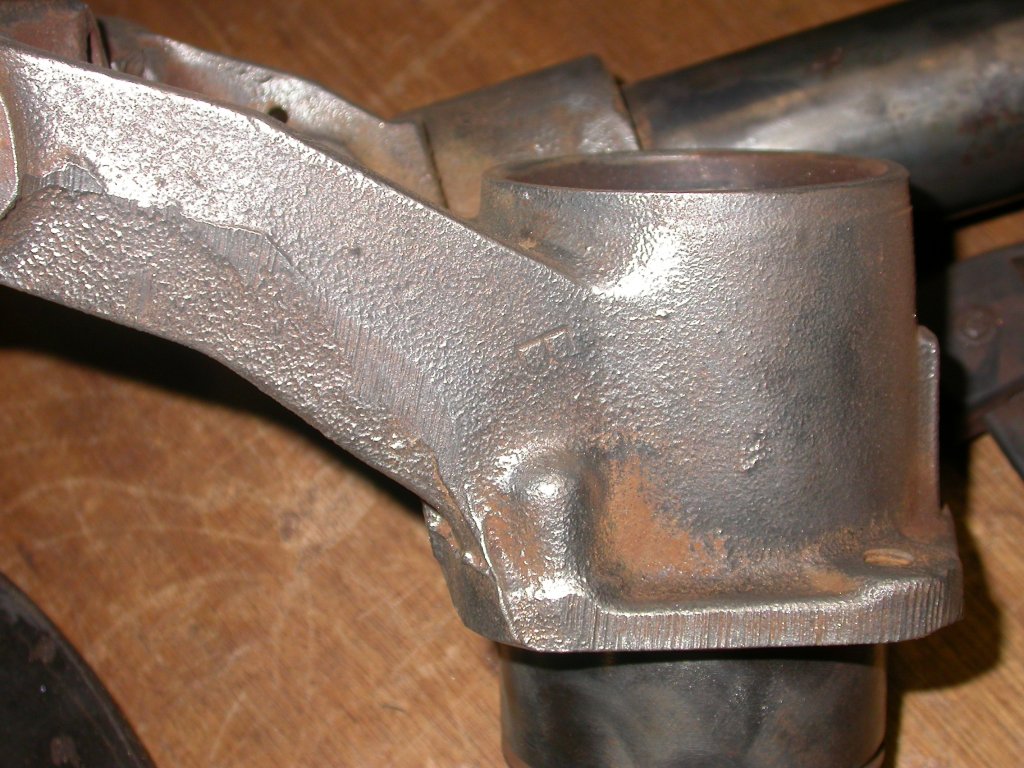

Another question on the rebuild. Can someone post a picture of the "B" mark on the hub that correspondes to the "B" mark on the spacer? Any help would be great.
Thanks,
Skip
I hadn't posted this before because Bambikiller has a similar pic in another thread, but I suppose it can't hurt to have it in two places. This is from a '78 280Z, but it looks pretty much like the one Bambi posted off a 240Z.
Marks pic of his clean hub shows it very well.
Yeah, the marks are fairly shallow in depth, so it doesn't take much paint, rust, dirt, or whatever to obscure the mark. I had to spray my spare hub with penetrating oil and apply a brush to remove debris in order to find the mark on mine.
