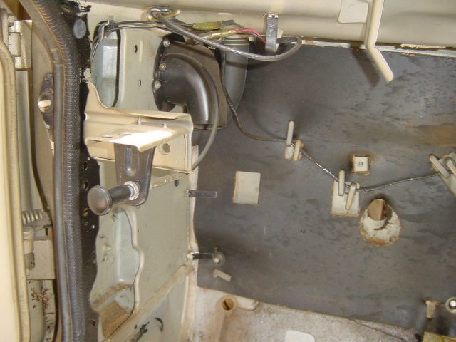

Does anyone have more pictures of the orginal matting?
I cant remember how it all fitted especially in regard to thinks like pedal boxes mountgin over the top i.e. does this mat sandwich between anything bolted to the firewall or was it cut in those places.
