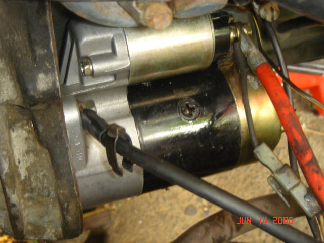

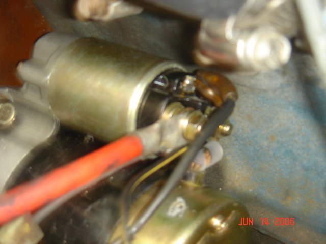

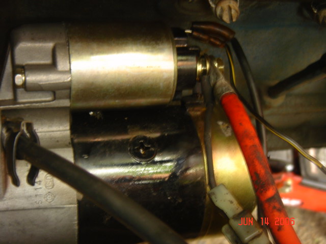

Reethi isn't the one that needs help. I am... Reethi already got his car started. But i'll try those thingd though. But like I said...everything was in perfect working order before I did the Auto to 4spd swapped.
here are some pix...Did I hook it up right? If I did than what is wrong? Oh and can I kill the starter by dropping the positive battery cable on the copper part of the starter(Man..talk about firework)?
