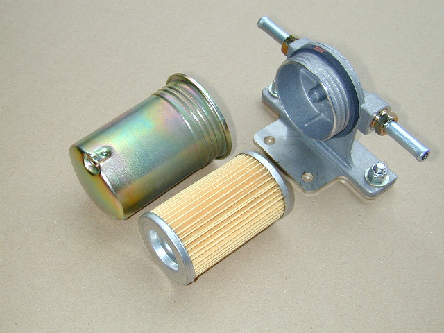

Just wondering as to what kind of filters (If any) everyone might be adding in prior to the electric fuel pump on the 75-78 model years. I suppose you could probably do the same thing on the early 240/260 models as well. I ran across an AC Delco unit that will make it quite easy to filter the fuel prior to the fuel pump, as well as changing the filter at regular intervals.

I was thinking more along the lines of "In addition to" and "Not in place of" the fuel filter up front in the engine compartment. I was thinking along the lines of using the fuel feed line out of the fuel tank, (Make a bracket to hang it on) but prior to the electric fuel pump. The little fuel filter in the intake side of the fuel pump is pretty lame at best, and somewhat hard to find if you need to replace it. At least this way it will do a really good job of filtering the fuel, and be easy to replace as needed.

About all I have is a url: http://hotrodparts.com/rollsbentleyparts/fuel-filter.htm
I already had the filtering unit, but I was trying to find out which other fuel filters could be used (I.E. - Fram, AC Delco, Napa...etc...etc, as well as the P/N for each), as well as a decent picture showing what it looks like. I was doing a search on the web and found this company that sells the whole thing...appears they are retrofitting RollsBentley's with this newer type filtering unit....looks like quite an improvement over the old filtering unit...four bolts vs. twist on twist off. At any rate tho, I was kind of curious as to what everybody else was doing to address this issue.
Some of the other filters that can be used with this unit would be:
AC Delco: GF-157
Fram: CG20
Napa: 3271
