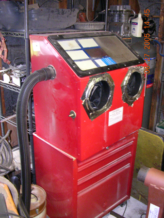

One of the cabinet sitting on top of a tool box. You can clearly see the rectangles of cardboard and the difference they make in clarity of the shield through use. You can also see the air nipple I installed, it has a female on the other end, and a whip hose between the gun and the fitting-its picture was too dark. Yes, I did tape up the glove mounting rings-they leaked dust before the shopvac...

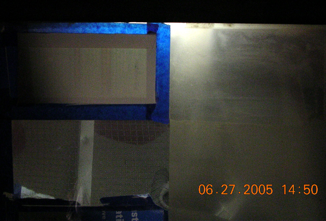

One of the lens and covering with the light on, clearly showing the low/no visability of the used half of the plastic shield, and the clarity of a recently uncovered/low use section of the shield.

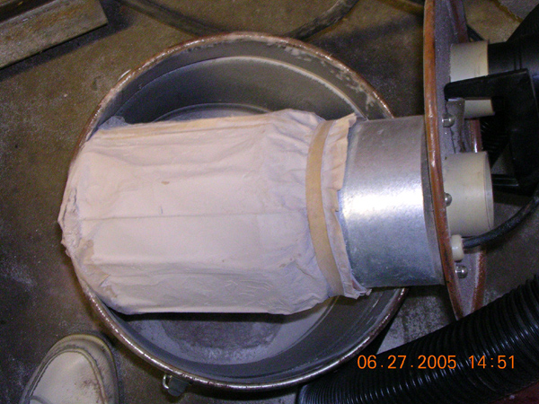

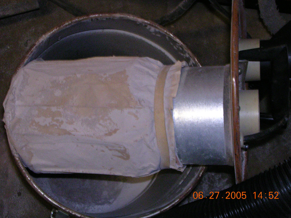

There are alos two pictures of the shopvac filter, the one with the uniform color is the dirty one-almost no air flows through it. I disturbed some of the dust to show the filter underneath in the next picture.

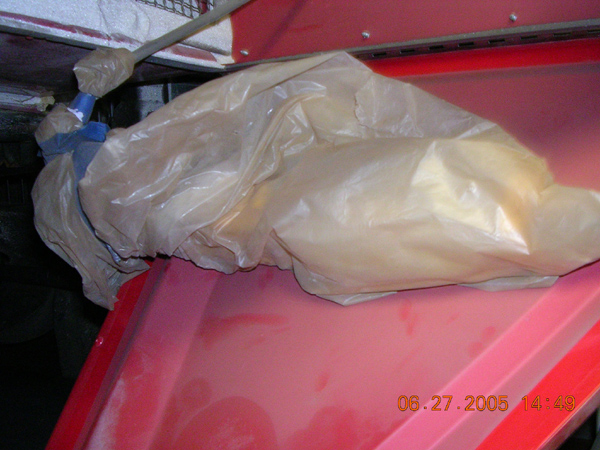

Finally there is a picture of the light in the bag-all taped up and dusty from use!
The magnet holds the light to the underside of the top of the cabinet.
TexasZ, If I didn't take the pictures you wanted, let me know, and I will take more.
