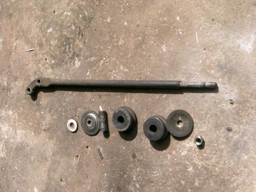

Posted June 22, 200519 yr comment_128205 I need some help. I searched the forums and found lots of info on TC Rods & possiable bending/braking issues w/ PU bushings, but my problem is different.When I mount the new PU bushings on the rod, the threaded end of the TC Rod is not exposed to put the nut on. I have the bushings and washer in the right order, but the new PU bushings appear to be bigger. My old bushings were way to trashed to get any understaning of what the original set up was. How do I compress this, or install it???Thanks in advance for any help...KCDCKeith Link to comment https://www.classiczcars.com/forums/topic/16333-tc-rod-install-wnew-pu-bushingshelp/ Share on other sites More sharing options...

June 22, 200519 yr comment_128216 I ran into the same issue when I upgraded my front end bushings. Unfortunately, I had a friend push really, really hard while I tried to get the nut onto a thread. Sorry no miracles, just brute force.Don't forget the silicone lubricant. Some folks did not use it and they report some pretty bad squeakage...Steve Link to comment https://www.classiczcars.com/forums/topic/16333-tc-rod-install-wnew-pu-bushingshelp/#findComment-128216 Share on other sites More sharing options...

June 22, 200519 yr comment_128223 Keith, I also had the same problem installing PU bushings on my 240Z TC rods. What I used to compress the PU bushing assembly was a large pair of channel lock pliers. Placed on both of the exterior washers, I was able to compress them enough to get the nut started. As Steve said, its just a matter of brute force! I suppose one could use a come-along to apply a load. If you attached it to the LCA (where the TC rod attaches) and to a point rearward on the chassis. This would certainly compress the front PUs. Just a thought! Link to comment https://www.classiczcars.com/forums/topic/16333-tc-rod-install-wnew-pu-bushingshelp/#findComment-128223 Share on other sites More sharing options...
June 22, 200519 yr comment_128227 I parked the front tire of my Z about 9" from a parking lot bumper that I was sure was anchored to the pavement (by way of rebar through the bumper into the pavement). The parking bumper had a wide bevel ( like this / ) on the face of it. Then I placed my floor jack, with the base against the bevel, between the parking lot bumper and the front tire. Make sure you place a wide, thick piece of lumber, like a piece of 2 x 6, between the tire and jack, and raise the jack until you have enough of the T/C threaded end through the hole to get the washer and nut on. Do this on both sides making sure both nuts are threaded on the T/C rod the same distance. That'll get you close enough on the alignment to take the car to a shop for a final alignment.BTW, before you start jacking the floor jack, make sure you have the parking brake on and the rear wheels are chocked so the car won't move backwards.I was able to do this by myself and it only took about 10 minutes to do one side. Link to comment https://www.classiczcars.com/forums/topic/16333-tc-rod-install-wnew-pu-bushingshelp/#findComment-128227 Share on other sites More sharing options...

June 23, 200519 yr Author comment_128333 Thanks for the replies.I'm rebuilding the entire front end so he car is on stands & I can't do the speed bump trick. I need to pick up a larger pair of Chanell Locks and give that a try. I had all the parts powder coated so I'll have to tape them or something to keep from marring the heck out of them....If any one else knopws an easier way...please let me know. Link to comment https://www.classiczcars.com/forums/topic/16333-tc-rod-install-wnew-pu-bushingshelp/#findComment-128333 Share on other sites More sharing options...
June 23, 200519 yr comment_128334 One good technique I've used to grip parts that I don't want to scratch up (such as the piston on strut) is to wrap it with a thick piece of rubber such as a rubber bungee cord, and then grip the outside of the rubber with the channel locks. If the rubber and the part are sticky enough you should get enough grip to hold it in place without ruining your finish. Well I haven't actually tried it on powder coating but it worked great on the strut piston which is maybe chrome or some kind of polished metal. Good luckMIchael Link to comment https://www.classiczcars.com/forums/topic/16333-tc-rod-install-wnew-pu-bushingshelp/#findComment-128334 Share on other sites More sharing options...
