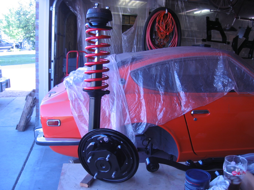

It took awhile, but I finally finished the rear suspension rebuild on my '73 240Z. I found the hardest part to be cutting out the old outer bushings on the transverse links. :lick: I used an air powered body saw to cut the old shells, but it took quite a bit of hammer & chisel work to persuade the old shells to come out.
The right spindle pin came out with just a bit of persuasion with a brass punch & hammer. The left side was rusted together pretty good. :ermm: I ended up taking the strut assembly & transverse link to an alignment shop and they were able to use a press to separate the two.
Once I had everything apart, I spent a few weeks cleaning all the pieces. Once clean, I sprayed the parts with Eastwood rust encapsulator, followed by Eastwood's Extreme Chassis Black. The parts turned out very nice, but the Extreme Chassis Black is glossier than the original black paint. I think that Eastwood's Classic Black chassis paint is closer to the original. But, for a weekend driver I think I can live with the glossier paint!

Anyway, I'm glad I'm finally finished with the suspension work. I started back in March. The most time consuming part of the whole project was cleaning all the parts to prepare them for new paint.
