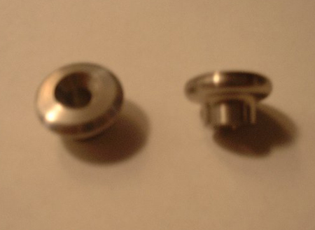

Here are a couple of shots I took of the seat belt hanger and rear window trim screw with clear plastic washer. I also took a picture of a page in the owner's manual that shows how the seat belt hook is used.
The interior of my '73 240Z was disassembled when I bought it. I found the seat belt hangers among a bunch of small parts that came with my car. The trim screw and plastic washer for each side were missing. I scrounged through several salvage yards to find the ones I have. :cross-eye
I have seen similar plastic "washers" at Ace hardware, but I think they were more of an off-white color, not clear. And, I haven't tried to find a new one that is the same size as the original. :ermm:

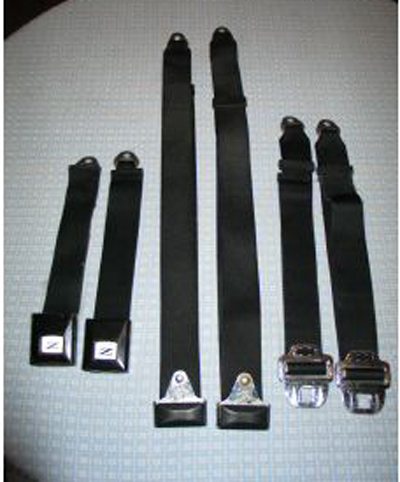

I think that all Z cars came with shoulder belts. You should have the attachment point up high in the quarter window trim panel. If your lap belts are original you can kind of twist the webbing on the male portion of the seat belt latch and you'll notice a hole where the shoulder belt portion attaches. When I bought my car in 1985 there were no seatbelts so I had to add some aftermarket lap belts.
Three point seat belts with shoulder straps were standard on all models from day one. The early early belts had black buckles and the top was a lift release like ariline buckles. The later series one belt buckles were push button release with a Z logo in the middle. The chrome hardware for the two varieties differs in shape and size as well. In both cases, the shoulder strap clips on to the lap belt as Mike indicated. Can't seem to find a picture of the early belts. Here are the later style non-retracting belts.
