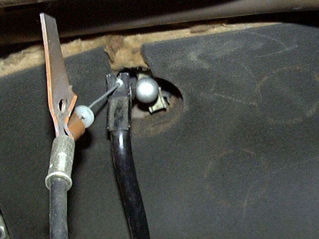

July 20, 200519 yr comment_131289 Something very important to note on the third picture in your collection. The picture that's labeled: throttlecableattachment3.jpg ; is showing the throttle cable mounted incorrectly. The Bracket shown in the first picture should be clamping the metal end of the cable sleeve. The 3rd picture shows it BEHIND it. The Nylon washer that's in front of the clamping bracket should be clipped ONTO the accelerator pedal "wishbone". The ball on the end of the throttle cable, does not attach to anything, it pulls on the nylon sleeve when you pull on the hand throttle lever. The design is such that it will allow you to accelerate MORE than the setting on the throtle lever with the foot pedal, while allowing it to return to the hand throttle position afterwards. I've attached the picture for those that might have a problem seeing your site. Enrique Link to comment https://www.classiczcars.com/forums/topic/16614-throttle-lever-can-it-be-fabricated/#findComment-131289 Share on other sites More sharing options...
July 20, 200519 yr comment_131298 Yes. That picture shows the metal hanger a little boogered up, but the idea is there. The plastic washer goes behind the pedal clip. The metal hanger has a captive nut on one side and thus becomes a bolted "squeeze" connection. This picture makes it look like is was pried open with a screwdriver.Texas, that auction was completely crazy. As I recall, the BIN was $350 or something. But the fuse box was new. That counts for something, I suppose. Still, I have been finding used long-tail fuse boxes for $35. Not $350. Link to comment https://www.classiczcars.com/forums/topic/16614-throttle-lever-can-it-be-fabricated/#findComment-131298 Share on other sites More sharing options...
