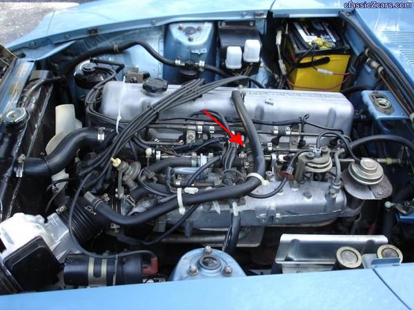

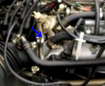

August 29, 200519 yr comment_136129 ok i have the #1 config. and i'm while the car manual shows me the #3 config..but i also think that it could be the #2 config with a cancelled hose that goes to the boot in front of the flowmeter.. but can anybody tell me where does the end of the hose on the junction which is against the valve cover end?? if the picture ws from the plan view it could be clearly seen! thanx.. On my car, which is picture #3, it connects to the fitting on the throttle body, just to the right of the idle adjustment screw, as viewed from the front of the car. It also connects there in picture #1. Picture #2 has it ending at the rubber boot between the AFM and the throttle body. Link to comment https://www.classiczcars.com/forums/topic/16723-california-280z-voluntary-recall-wtf/?&page=2#findComment-136129 Share on other sites More sharing options...
August 29, 200519 yr comment_136156 Stephen, i gues that u got me wrong, it was hard to explain:) i asked about the hose that is noticed by the red arrow in the picture, where does it go from the juntion that is under the valve cover hose on the #2 config? if u have the second config. do u have a very strong vacum under ur oil cap? that u hear the air sucked to the engine while opening the cap?? Link to comment https://www.classiczcars.com/forums/topic/16723-california-280z-voluntary-recall-wtf/?&page=2#findComment-136156 Share on other sites More sharing options...
August 30, 200519 yr comment_136209 Sorry but I have config 3 so my car doesn't have that junction. I have a slight vaccum at the oil cap and when I remove the oil cap, the idle drops about 75-100 rpm. Link to comment https://www.classiczcars.com/forums/topic/16723-california-280z-voluntary-recall-wtf/?&page=2#findComment-136209 Share on other sites More sharing options...

August 30, 200519 yr comment_136242 well the vacum under my oil cap is really strong! and the car gets dizzy just after removing the cap and the engine dies after a while, i tried to adjust the flow meter coz i thaught that more air is passing through it now but nothig helped, but i cant understand how can the engine make this vacume, coz i have the first configuration right now!could there be a nother problem? like the thing under the throttle body, has a name like EBDD i guess ? Link to comment https://www.classiczcars.com/forums/topic/16723-california-280z-voluntary-recall-wtf/?&page=2#findComment-136242 Share on other sites More sharing options...
August 30, 200519 yr comment_136245 Well, to comment on Enrique's post, the whole California smog thing is a racket. I've been to very few shops that have any idea what is supposed to be on a 280Z. My car has never failed a smog test. I have passed with failing efi components. I have passed with a homemade cold air intake on my car. All they really want is your money. BuDavid, I think you mean BCDD. Does your car have factory air conditioning? I noticed that on my 810, that hose under the one that goes to the valve cover connects to the FICD for the a/c system. When I pull the oil cap off of that car, there is a lot more vaccum at the opening than there is on my Z. That's probably because that connection is pulling vaccum directly from the intake manifold as it appears in config 1 and 2. Since my Z is config 3 it doesn't have that connection. Link to comment https://www.classiczcars.com/forums/topic/16723-california-280z-voluntary-recall-wtf/?&page=2#findComment-136245 Share on other sites More sharing options...
August 30, 200519 yr comment_136246 what is the FICD!?yes i do have the A/C system, i would die withot it here;)maybe the low vaume u have under your cp is due to the #3 config, coz the house the connects the boot between the flowmeter and the throttle body i think reduce the vacum while the throttle is blocking in idle running..we conclude from your 810 that the strong vacum under the oil cap is a normal thing, the unstability and engine death problem under the 1000RPM is from wht then!?:si read in the owners manual that the hosing system the connects the valve cover and the PCV valve is used for burning unburned gases in the block, and fresh air is sucked from the valve cover through the upper hoses and run into the block to mix up with those gases to perform air drift in the block and then sucked by the intake vacum through the PCV valve to be burned again..is it useful to cancel the valve cover hose and put a small circular air filter? i saw some engines have them, but i dont know what is the purpose of it, it might help reducing the vacum a little bit, doesnt it? Link to comment https://www.classiczcars.com/forums/topic/16723-california-280z-voluntary-recall-wtf/?&page=2#findComment-136246 Share on other sites More sharing options...
August 30, 200519 yr comment_136247 ok stephen, i found an older post about the FICD, i dont really think that my car have a similar thing, since it has an AC.. i had something like it on my 280ZX that i had b4, but mine has simply a vacum tank in series with the vcum switch.. I'll go and check under the hood, if the FICD is the valve with two vacum hoses it might be it?it is ob the upper right of the intake when u are on the drivers side of the car? Link to comment https://www.classiczcars.com/forums/topic/16723-california-280z-voluntary-recall-wtf/?&page=2#findComment-136247 Share on other sites More sharing options...
August 30, 200519 yr comment_136248 I'm not sure if the 78Z had that same setup from the factory. Mine has aftermarket air conditioning so it doesn't have the FICD. What I was describing is on my 79 810 which is similar to config 1 but not exactly the same. The 810 stumbles badly when you remove the oil cap but runs fine when it's on. My Z drops rpm when you remove the cap but continues to run at that lower rpm. I wish I could be of more help here but I've never experienced the problem you're having with either of my cars. Link to comment https://www.classiczcars.com/forums/topic/16723-california-280z-voluntary-recall-wtf/?&page=2#findComment-136248 Share on other sites More sharing options...
