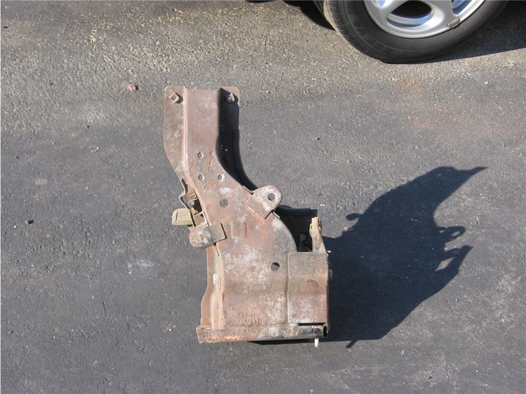

August 2, 200519 yr comment_132797 Here are the pictures. Link to comment https://www.classiczcars.com/forums/topic/16740-auto-to-5-speed-swap-out/#findComment-132797 Share on other sites More sharing options...

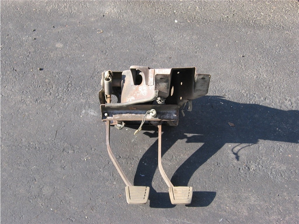

August 2, 200519 yr comment_132798 Here are the pictures. Link to comment https://www.classiczcars.com/forums/topic/16740-auto-to-5-speed-swap-out/#findComment-132798 Share on other sites More sharing options...
August 2, 200519 yr Author comment_132800 Thanks. That is what the assembly looks like that is already in my car it has the hook up for the spring on top and a threaded hole for the bolt that holds the clutch pedal, yeah mine looks exactly the same except for there is no clutch pedal arm . How about you just send the arm with the bolt and the round thing that goes around the bolt and the spring and I will send you 20.00. Thanks for the pics. Link to comment https://www.classiczcars.com/forums/topic/16740-auto-to-5-speed-swap-out/#findComment-132800 Share on other sites More sharing options...
August 3, 200519 yr comment_132807 You'll need the whole assembly because, if memory serves me correctly, the a/t brake pedal is wider and would interfere with the clutch pedal. Link to comment https://www.classiczcars.com/forums/topic/16740-auto-to-5-speed-swap-out/#findComment-132807 Share on other sites More sharing options...

August 3, 200519 yr comment_132853 you dont need the entire bracket... there's a bolt and the pedal.. and a spring...all i did was simply swap out the pedals and bolts because the pedal assembly has the hole to mount the master cylinder and pedal... Link to comment https://www.classiczcars.com/forums/topic/16740-auto-to-5-speed-swap-out/#findComment-132853 Share on other sites More sharing options...
