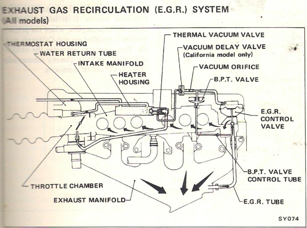

My '73 originally had an N33 intake/balance tube with an EGR valve. I have since replaced the intake/balance tube with an E46 from a '71. It does not have the EGR valve. The first attached photo is of the N33. The second shows the E46. Hope this helps!
Yes i notice the difference in the manifolds.. I think im going to put the 280 manifold back on or fabricate the heat shield so i dont have to go through all that trouble again.. As for it running bad it seems perfectly fine. I havent even adjusted the timing yet since i got it. Once i get everthing tuned right ill see if i need to swap the old manifold back on.
